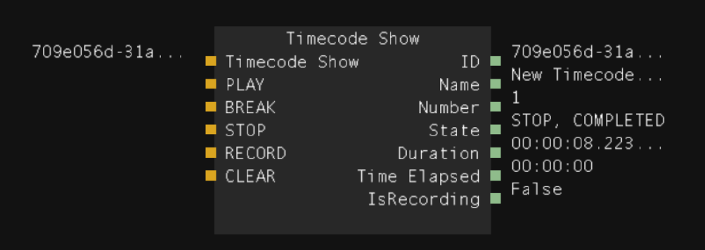

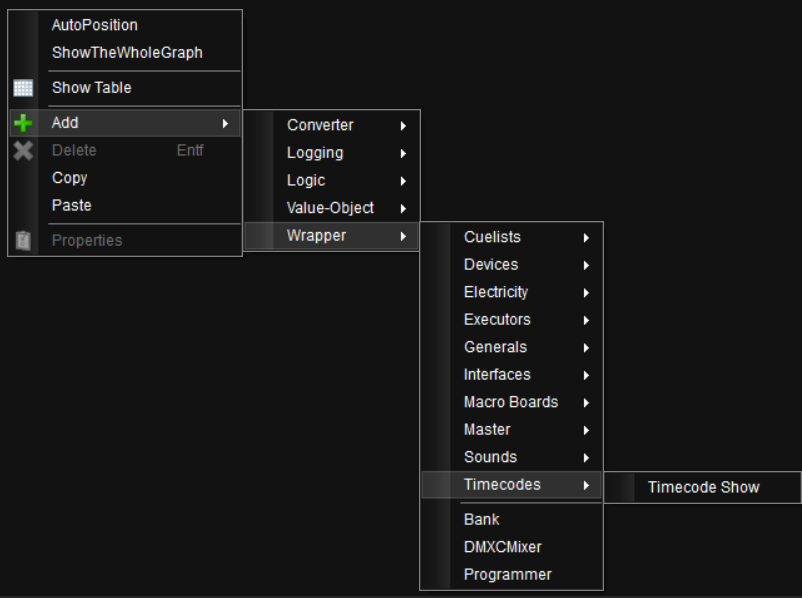

  • I don't know why you think, there is no direct way to control timecode shows with the Input Assignment. Actually, there is a way (you can see it in the attached screenshot. There you can control the timecode show directly. You can even see the status of this timecode show (state, duration, elapsed time and if it is in recording mode).
    nutzer99 give me the executor way and now, JPK give me another way ... many thanks, it's more than I hope.
