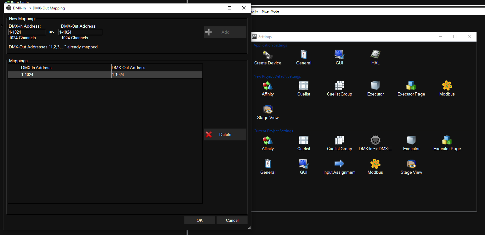

Hmmm ok, this is bad news. I don't know, if we have a final solution until tomorrow. BUT: Try the following as some kind of hack: Send Art-Net-Signals with DMXControl 3.3.0 to a second computer with DMXControl 3.2.3. There, just map DMX-In to DMX-Out with the direct mapping. You can find it in the settings of DMXControl 3.2.3 under "Current Project Settings" => DMX-In => DMX-Out. In addition, configure Art-Net as input in DMXControl 3.2.3 and your interface as output.
I hope, this will help you for the short term. For the long term, I wrote to the other developers internally so we will take a look, why this is not working.
Ok thanks, why not, it could save the deal ...
