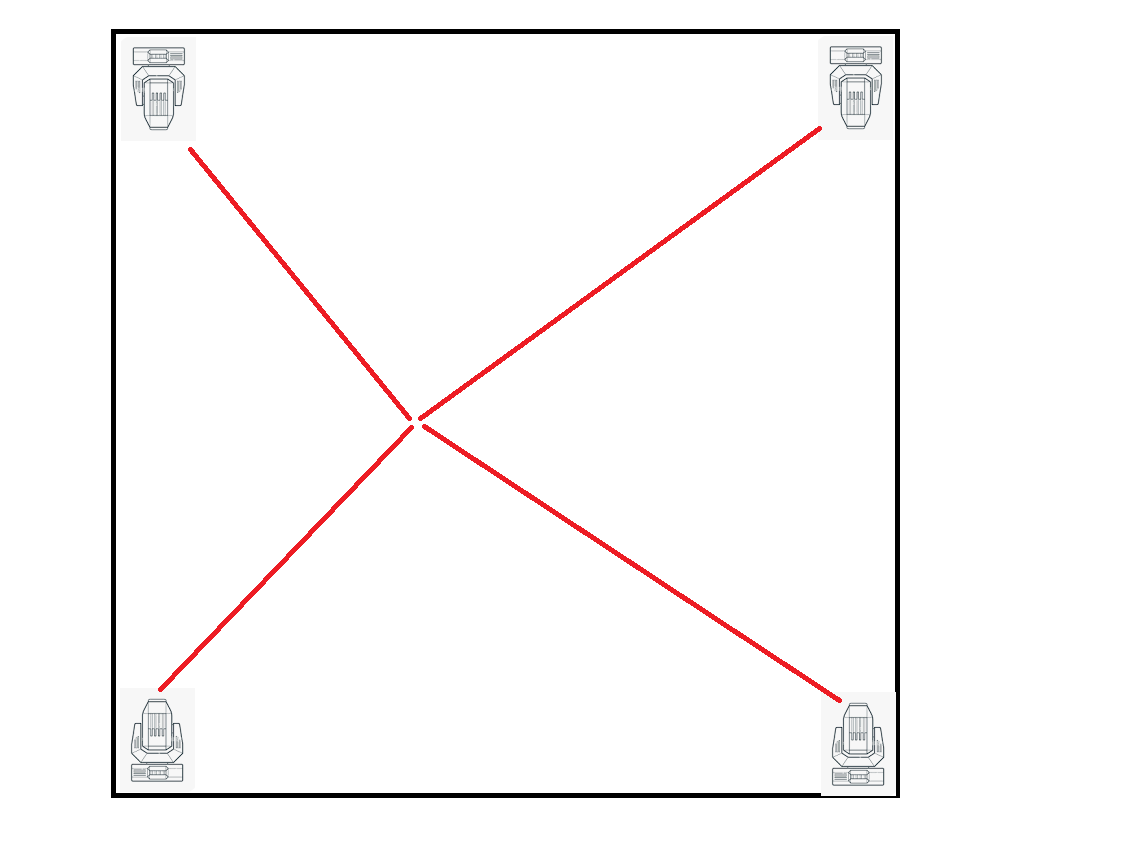

    Here is my scenario:
    I have 4 moving heads, one in each corner of a room.
    I would like to calibrate them to the floor, and create effects where they can move in sync. Essentially I want to map them to a coordinate system of the room.
    They should be able to point to the same spot, and from there pan/tilt in sync across the floor. This would also facilitate fanning and effects.
    Another software I tried was PC_DIMMER, and it had such a calibration feature in the device settings
    How can I accomplish this in DMXControl 3?
    Here two examples; all pointing and following the same spot on the floor with pan/tilt movement, and the second one where they are fanned and following a circular pattern, for example

  • Hi and welcome in our forum,
    currently (DMXControl 3.3.1) there is no mapping option available yet. So no, you don't do anything wrong. There is simply not the option for that yet.
    However: As a hint: Watch the upcoming livestream about the features of DMXControl 3.3.2 ;) (we already said, that there will be such a video in the nearer future but we did not released a date for it yet). But what I can make clear: The fanning option (your second image) will not be without some workarounds. But yeah, stay tuned ;)
