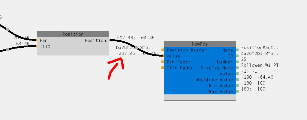

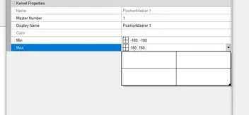

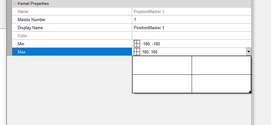

    Ein Position Master kann tatsächlich manuell so eingestellt werden, dass er -270; 270 zulässt, jedoch nicht über die GUI; diese ist auf -180; 180 beschränkt.
    Beachte jedoch, dass die Position auf -180; 180 zurückgesetzt wird, sobald das Feld in der GUI bearbeitet wird..

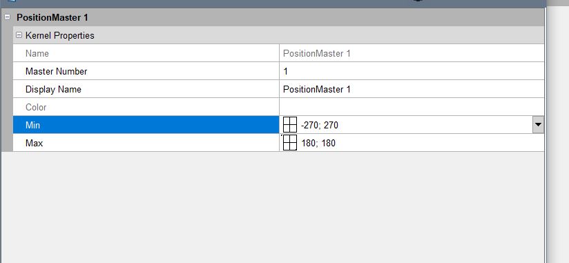

    Aber warum funktioniert es nicht, wenn ich einen Rule-of-Three-Knoten verwende und -270;270 vorher in -180;180 umwandle, bevor ich es so zuführe!?

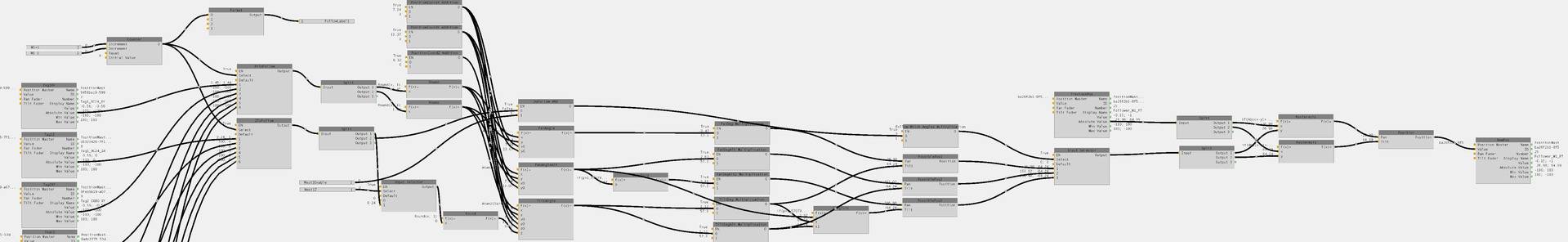

    Ich habe einen Screenshot des Diagramms angehängt. Ich glaube, ich nutze die IA für Dinge, die an die Grenzen dessen gehen, wofür sie ursprünglich gedacht war, aber im Moment scheint es zu funktionieren.
    Sry, das forum verkleiners den Screenshot hier auf fast unlesbar.

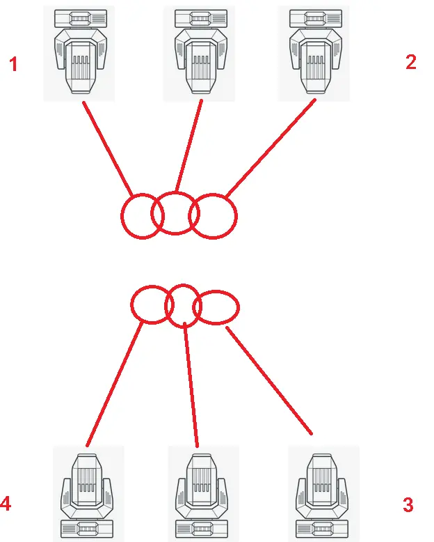

    I have a room layout as shown below.
    - The moving heads are symmetrically on both sides of the room.
    - They have been calibrated in a position mapping to corners 1-4 to overlap (in both lower as well as upper reference planes)
    - Then set to the center position in the programmer and turned
    - In that position, they shine into the respective spots, but do not overlap at all (especially side to side, there are meters in between the two rows.
    - In the corner positions they overlap well.
    So my question is what am I doing wrong that they are not overlapping better in the middle positions?
    I can get the two rows to overlap a bit better by adjusting the "normal" value, but that of course throws off the corner mappings.
    I have also tried using cartesian or polar coordinates in the mapping but cartesian does "weird things" compared to polar.
    Understandably the side-to-side offset *could* be alignment error, but it is about half a meter off or more.
    There is no way I got the front-to-back alignment between both rows of heads far enough off to cause several meters of distance.
    So again, what am I misunderstanding and how could I fix that?

    - A position mapping (as a device) logically should only represent a single device: allowing a single mapping represent multiple devices will likely cause other unintended side effects in addition to only getting one fanning value
    - Your workaround of one mapping per device and then grouping the mappings is actually how it should be (imho).
    The best (abstract) solution might be:
    - Allow only a single device in a mapping (1 to 1)
    - Use device groups (manually created as with normal devices) to fan and do other things with position mappings
    - Modify the calibration dialog to allow showing multiple mappings at the same time if desired (as it shows all devices in a single mapping now) : This would allow calibrating them all at once, as it is now
    This would retain the proper structure (separating devices and groups) and thereby not break fanning or other logic, allow the convenience of calibrating multiple mappings/fixtures at once, and still allow multiple different mappings to be used on a single device.
    Hi,
    It seems like the device group or "shadow mapping" could work as the workaround does the exact same thing. A device group would also allow for multiple position mappings because I could still create multiple groups with the same devices, and the group could have the "Patching Field", no? Maybe there is something I am missing internally as I don't understand or am familiar with the core architecture.
    Regarding the merging, I meant only in the stage view/programmer.
    - Create 3 devices 1,2,3
    - Create 2 Device groups (Devs 1,2 and Devs 2,3)
    - Create a fanned position in Group 1, then Group2. Switch back and forth and only one groups has a superposition of all.
    I have attached a sample project and a steps recorder PDF. I somehow cannot record a video in the VM...
    Thank you for the cursory overview of the underlying issue.
    What is the purpose of being able to apply a fanning to a single device? Are there any useful scenarios or just a byproduct of the logic?
    I suspect there was a very good technical reason for this, but:
    Why is the position mapping implemented as a device rather than a device group?
    Maybe when creating a position mapping it should create an automatic "shadow group" that could be used to apply the fanning? This should be analog to the workaround of multiple mappings inside a single group.
    I am not super familiar with DMXcontrol or DMX in general (new to this and only as a little side thing), but it seems to be possible to apply different fannings to device groups containing the same devices (like overlapping fannings).
    These fannings are then somehow merged into the last edited group, is that correct?
    In that case such a shadow group might work (as multi-group spanning fannings are already handled in "some way"), but I am not 100% sure how these overlapping/conflicting fannings are merged.
    Does that make sense or it is too obscure to understand what I'm trying to say?
