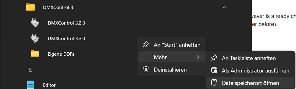

  • Hi,
    yes, this is possible. As you can see in the image below I have DMXControl 3.2.3 and DMXControl 3.3.0 parallel on my PC. The installer however is already changed so it keeps only one version in the start menu. One trick is to rename the shortcut to DMXControl 3.3.0 in the start menu first (by right click on it and find it under "more"=>"open in filesystem" (in my screenshot you can see, where to find them beside the fact, that they are in German).
    After that, just reinstall DMXControl 3.2.3 over your existing one (but backup the DMXC 3.2.3 folder before). Then the links should be recreated. I have only the shortcut to start GUI and Kernel together and removed the other ones because I don't need them.
    However, there is a catch: Both versions would use the same application settings folder. While this can work fine, it is better to separate them. You can separate them by specifying an Environment Variable in Windows. The necessary ones you can find in the following (unfortunately only in German available) article: https://wiki-de.dmxcontrol-projects.org/index.php?titl…gebungsvariable. But the table should help to show you the name of the variable. Then in your system, you only need to specify the respective Environment Variable and add there the path to the folder, where the settings should reside. With this little extra step (which is planed that the installer will do this automatically) you can separate the settings of DMXControl 3.2.3 and 3.3.0.
