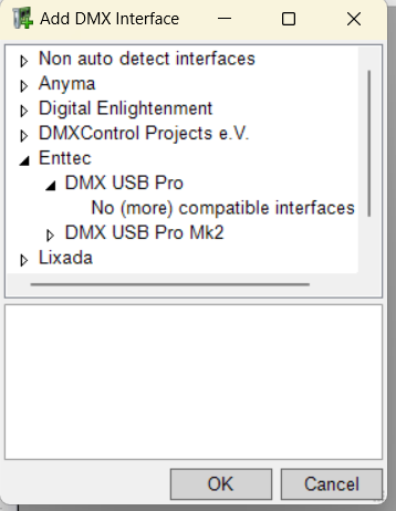

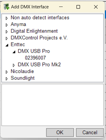

    But when I want to add my Enttech DMX USB Pro with 3.3.0 RC2, it's just not visible in DMX Interfaces. It works great with DMX Control 3.2 but not recognized in 3.3 !
    I'm totally lost, my whole show is based on Timecode but without Enttech DMX output, it's just not possible.
    I tried on my desktop computer and same issue, Enttech is just not visible.
    With DMXControl 3.2:
    With DMXControl 3.3 RC2:

    we know already about that problem, that the Enttec USB Pro is not working currently with DMXControl 3.3.0. We have also a ticket in our bugtracker for it: FS#5259 : Enttec USB Pro DMX Interface wird nicht erkannt.
    Unfortunately I just can ask you if you are maybe able to add the logfiles to that ticket to help to fix it for the final release. But a quick fix until tomorrow won't be possible - especially without having any detailed logfiles to follow up, where the problem is.
