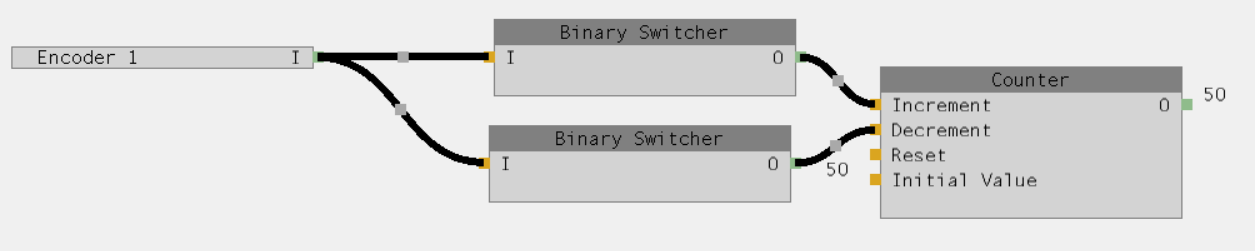

  • Thanks for this feedback. I tried the following:
    • Encoder 1 is my MIDI encoder input: when I go clockwise, value is 1, when I go counterclockwise, value is 0
    • the first Binary switcher is activated on clockwise move (On value set to True, Off value set to empty)
    • the second is activated on counterclockwise move (On value set to empty, Off value set to True)
    • Counter node increment and decrement steps are 1
    If I move clockwise, the first Binary switcher is activated:
    and the value of the counter node goes to 51.
    But if I go clockwise another time, the counter value is always 51.
    If I go counterclockwise, the counter value goes back to 50 but after that move, my MIDI encoder has no more effects. Binary switchers works, if I go clockwise, the first one is activated and send True to Increment, if I go counterclockwise, the second one send True to Decrement but the counter value is stucked at 50.
    Remark: I think the main issue is that only the change from clockwise to counterclockwise is triggered by the Encoder box. I mean at start, if I go clockwise, an event is triggered, if I go another time clockwise, nothing happens, if I go counterclockwise, an event is triggered, if I go another time counterclockwise, nothing happens ...
