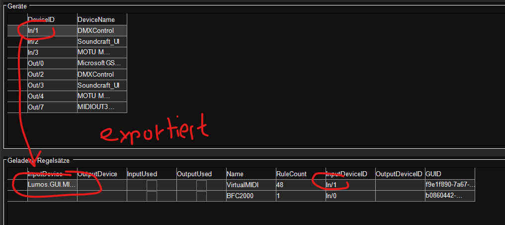

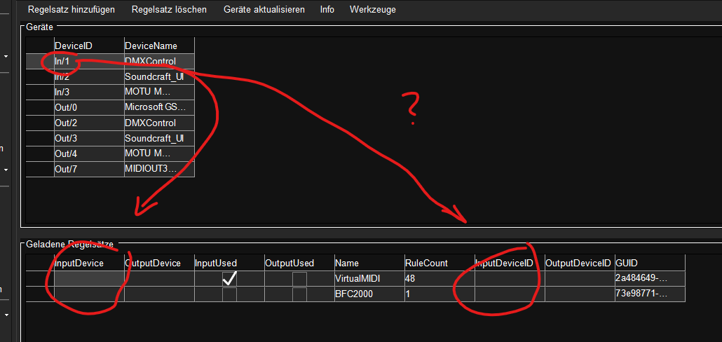

    Here two screenshots: first as exported from running Project, second after import in new Project. Same PC, same running Kernel, all devices still connected.
