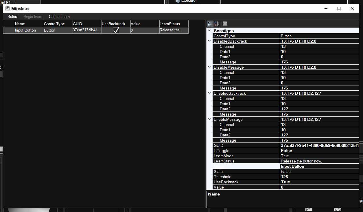

  • Hi and welcome in our forum,
    the IA is the right place to link the midi input to the cuelist in the same way you have linked the keys of your keyboard. However, there are a few steps missing to get it working. The first thing is to configure the midi controls. For an easier description, I took my Traktor Kontrol F1 as an example device in my following screenshots. I describe the setup first without connecting the midi device to meet your current situation. First, open the "Midi Manager" (in the top menu bar, "Settings"=>"Midi Manager").
    The Midi Manager has two sections, the upper one with the midi devices, recognized by DMXControl 3 (here you can see my F1 and the Windows Synthesizer) and the lower section with the so called rule sets. We start by adding a new rule set by hitting the "Add rule set" button. A new table row appear in the lower table. This rule set describes the controls, we have on our midi controller (or at least the ones, we want to use). By double-clicking this new entry, another window opens. There we add the controls (here called rules).
    I added a button and there are now plenty of information :D In short, in the table on the left, there are the controls. We give this button a name e.g. "Input Button". On the right there are many settings, on how this button works. In detail, there are settings, which midi messages are the enable and disable messages (and some other settings). For now, we leave them as they are (they will get relevant when we connect our midi device). But for now, we close this window and have now a rule set with one rule. And now, our button pops up in the Input tree of the IA.
    Now, you can connect this input as the keyboard inputs. If you have received the midi cable, then you can link the midi input with the rule set. For this, you open the Midi Manager again, and add the ID of your input device to the "InputDeviceID" column like I did in the next screenshot with my Kontrol F1:
    After that, we have to learn the controls in our rule set. Fortunately, the rule set configurator has a learn function. So we select the according rule / control and hit the "Begin learn" button. Now we can send the according midi message from the controller for on and off and the rule is configured. This should look like my configured button:
    Now, a midi message should trigger the midi input in the IA like in my test:
    I hope, this little guide helps you to configure your midi input.

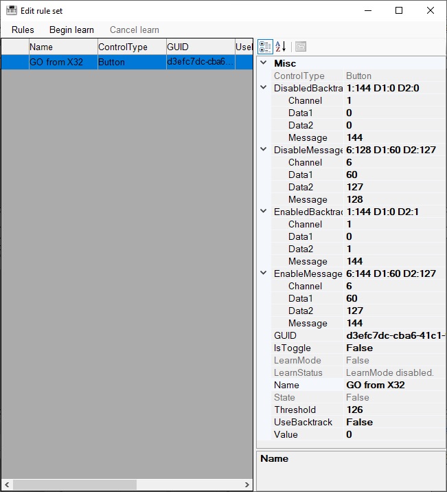

  • OK.I re-thought the whole situation and I suddenly realized that the X32 is a pretty advanced implementation of midi, included OSC and that perhaps the settings of the midi interface needed te be reviewed.
    So, I did. I switched off every specific setting, so I was left with the setting for the correct midi interface, no more, no less. All other check boxes were off. And that made the big difference.
    I defined for every cue one same note, applied the learn process within DMXControl 3 and ... tada ... it works.
    General midi settings on X32:
    Midi settings for a cue in cuelist:
    Rule settings after learn process in DMXControl 3.2.2:
    I can go on now and build the complete cue-list for the show in DMXControl and in X32.
