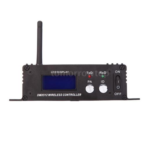

    I been looking at this one, China & it has a lot of options (Front & back View & it comes w the both the Transmitter & Receiver)

  • 1 x Wireless DMX Transceiver(Transmitter & Receiver)
    It means the device can transmit or receive the data, but only one function at the moment.
    When device detects dmx signal connected to its input it become trasnmitter. If there is no
    dmx signal connected the device is scanning for wireless signal.
    I use this device as transmitter. In 25 m distance it works without any error. Longer distance I
    didn`t try.
    I was very incredulous about dmx wireless until tried. It is very convenient. There is possibility
    to connect to receiver more than 1 dmx device.

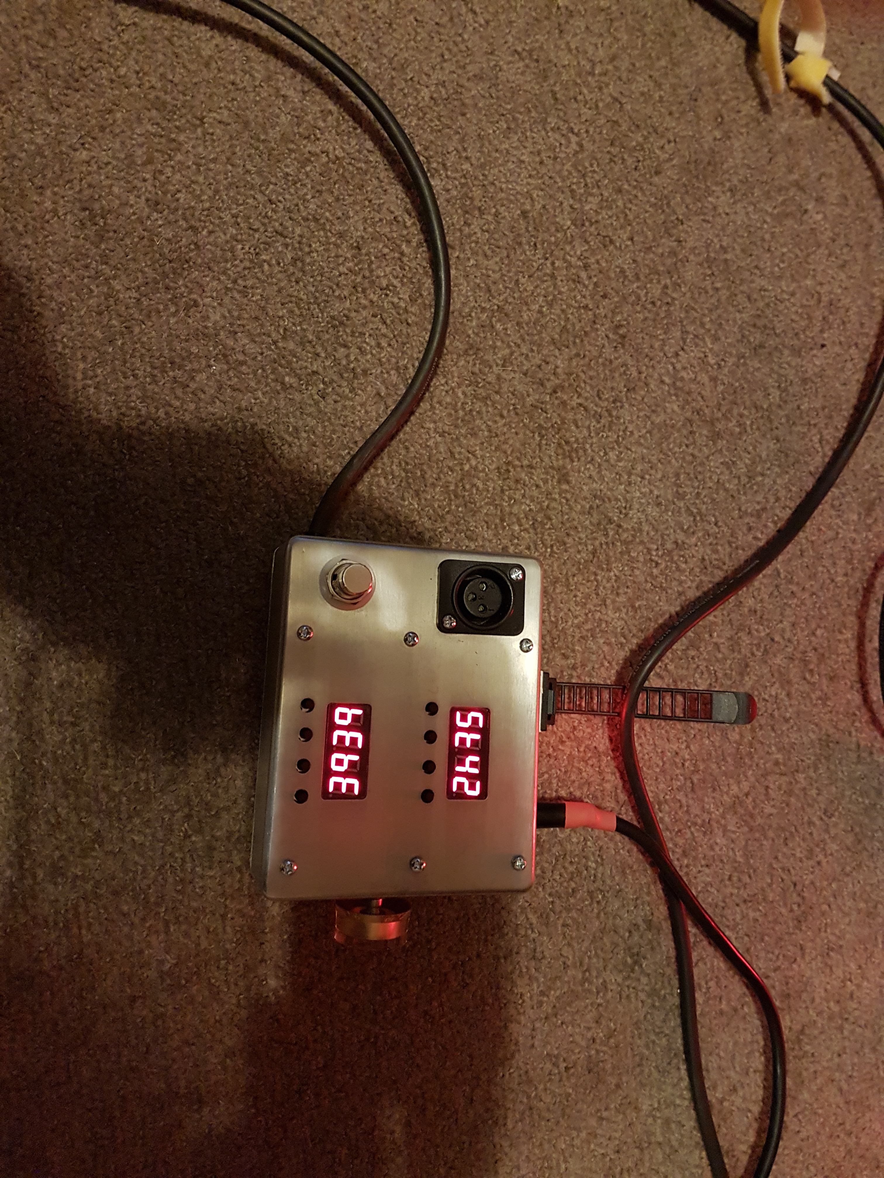

    sorry for the dredge, but there really doesn't seem to be a lot of chatter (that I can find) about the ins and outs of these. I bought some of these boards. wired a couple up and got tx rx happening nicely on the LED indication, but the lights don't pass the dmx.
    I'm using cheapo chinese LED quad LED par64 that work perfectly via DMX cable, but when I use the small integrated boards, no dmx passes despite the LED indicating tx and rx being successful.
    so then I tried the external wifi ones thinking maybe I'd wired the others wrong but same issue... rx tx indications are good to go, but the slave stays blank.. throw in a DMX cable and it works fine, replace back with the wireless ones.. nothing.
    so then I tried the same on some moving head lights I have... and the wireless works here... wat?
    is there some different type of DMX for different lights? they're booth standard 3 pin xlr style.. any help gratefully received. I'm way confused

    thanks JP.. weird that both work fine with DMX cable, but when I use the wireless only the moving head ones work though?
    what I mean is..
    cheap puck to cheap puck via cable.. works
    moving head to moving head via cable.. works
    cheap puck to cheap puck wireless.. fails
    moving head to moving head wireless... works
    if there's a datarate issue, can I address that somehow?
  • hmmm only if you can edit the datarate and other parameters of your wireless modules, because they work on the receiving side as new sender and generate a new DMX signal (ofcorse with the data received on the wireless transmitter side). So you have two DMX lanes with the wireless nodes:
    • DMX console => moving head => wireless transmitter
    • wireless receiver => moving head
    regards
  • nope.. I don't have a console (as such).
    I have a pair of moving heads.. set one as master (to sound, or strobe or chase or whatever). tx wireless from that goes to rx wireless on the next (moving head) set to A001 slave.
    works perfectly.
    replace the wireless with a cable.. works perfectly.
    now puck set to sound active -> same cable -> puck set to A001.
    works perfectly
    puck ->same wireless tx rx units ->puck set to A001
    fail
    I kinda have a console (and have tried with it too and it also fails on wireless, succeeds on wired)
    so my 'console' is actually one I made. I have little to no need of anything fancy, so I purchased 2x spare boards from these pucks.
    one board is set to strobe, one to sound. the DMX out goes to a 3pdt stomp switch (and I have a sensitivity knob on it for the sound). during a gig our bassist can stomp to swap to strobe, or back to sound active by jumping on it. it's housed in a standard guitar style pedal
    I even tried wiring in one of the cheap wireless boards for tx.. but when I couldn't get that working I tried the external type in case it was my wiring (didn't think it was, but wasn't sure).. seems to be the pucks are odd

  • thanks hothand.
    I've had it explained to me now.
    the issue is that some of the cheap chinese pucks have DMX in and out sockets on them (even has the term "DMX" written on them and in the
    literature), but it is in fact a proprietary system. so the cables work sweet (copper is copper) but the wireless (send) fails because they are
    designed to transmit 'true' dmx.. the wireless boards and the external ones are not able to xmit the proprietary protocol.
    the pucks (I'm told) are able to receive DMX, but can't what they send if they're set to master is not true dmx.
    sucks that they're (the pucks) being sold with misleading information, but at least I know and can stop chasing the dragon on the gear I have.
