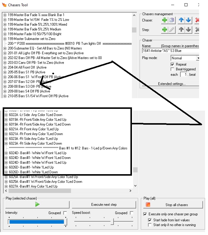

    Chases Tools
    Is it possible to open the Chaser tools File (Using a text file or ????)
    and move multiple Chases to different location in the file?
    This would save me a lot of time.
    If not is it possible for a Programer do it?
    Thanks Steve
