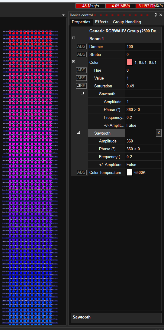

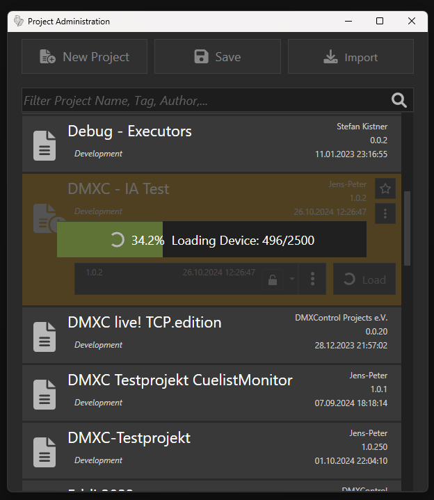

    To have some current tests for that, I changed the number of universes to 64 in my development environment and tried to fill all universes with Generic RGBWAUV-devices (those are currently available in my environment). All tests were done with detached debugger so this is the performance of DMXControl 3 without interference. I was able to create ~5000 devices when I ran into the out of memory exception. Down to 32 Universes, I managed to add 2500 devices (which use a bit more than 29 universes). I was even able to save and load this project and run two effects on the device group, which produced ~31200 DMX values per second (see both the images).

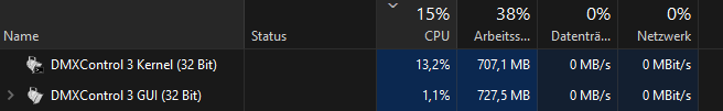

    However, I had multiple issues in this test. I ran multiple times in the out of memory exception e.g. when I wanted to change the arrangement of the devices to a wider block. There were also some other crashes. In addition, the 31200 DMX values per second sound like a lot. But if you do the math, you will see, that this value should be even higher for a proper usage. With those two effects I controlled 5 out of the 6 DMX channels (R, G, B, W and A). So 31200 divided by 5 channel divided by 2500 devices gives us ~2.5 frames per second per device while my CPU is "sleeping":
