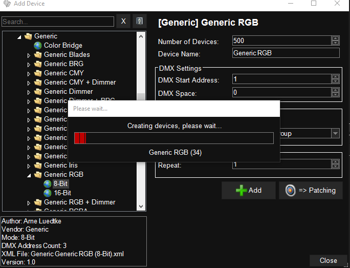

    My main test in both versions was to load in as many "Generic RGB" devices as I could to see how it would handle running hundreds of simple devices simultaneously.
    I also wanted to test the efficiency of the way DMXControl handled Matrixes.
    So in both versions, I began by initially loading 500 "Generic RGB" devices. This was the maximum amount that the application would let me add at one time.
    If I wanted to say add another 500, I would simply have to initiate another instance of importing the fixtures.
    This was my immediate result which I will attempt to explain as best I can.
    First, in 3.2.3, I found that loading that many devices at once took a crazy long time for the application to load in the fixtures, with one exception.
    When I began adding devices, I was adding them primarily by going into the "Devices Window" -> Right Clicking -> Add Device inside of the "Devices Window".
    With the device window still open, it took probably about 5+ full minutes of waiting for DMXControl 3.2.3 to add all the devices at once if I was lucky. DMXControl 3.2.3 would be locked until all the devices were finished importing into the project. I believe sometime this would also crash the application.
    I then discovered that if you do not have the "Devices" window open (rather keeping say the "Cuelists" window in focus), and instead add the fixtures using the "Add Device Button" at the top of the main Project Explorer window, adding the same amount of devices produced a progress bar, and resulted in a significantly less time (less than 30 seconds) to add the fixtures to the project.
    I also discovered, that in the stage view, when viewing the graphical display, the visualization was very very choppy with that many fixtures added to a stage view window. (I believe it was after about 150-200 fixtures is when the results became choppy) and eventually you could not really tell what was accurately going on with chasing sequences.

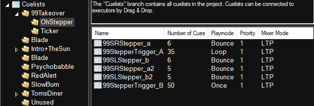

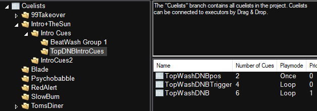

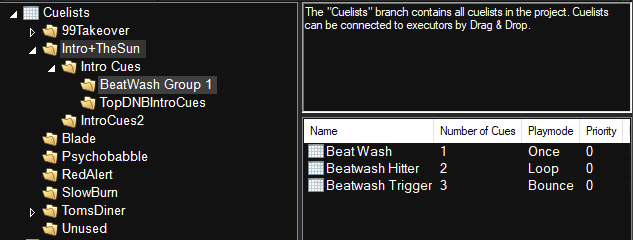

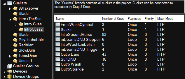

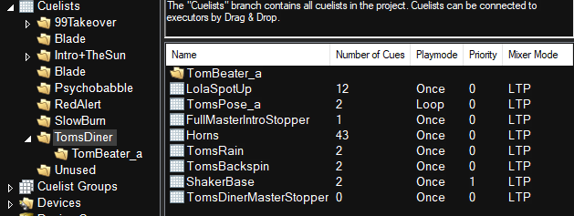

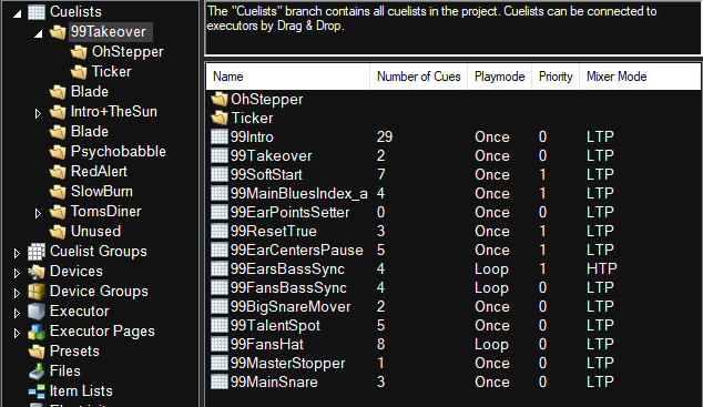

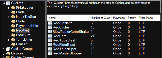

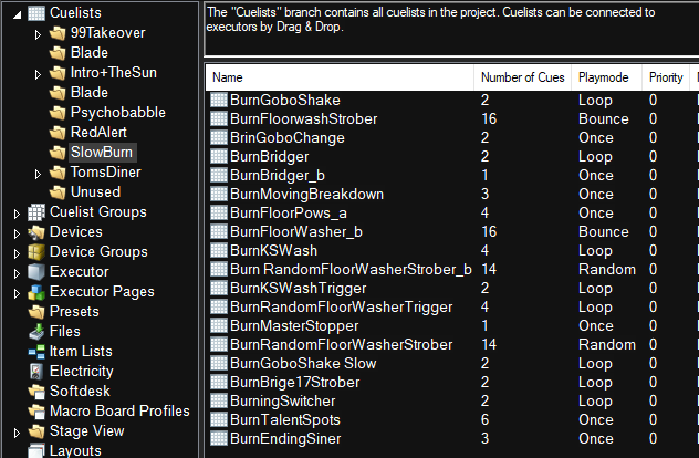

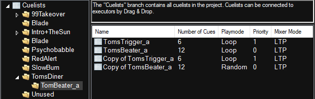

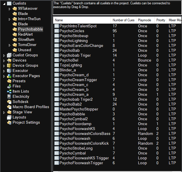

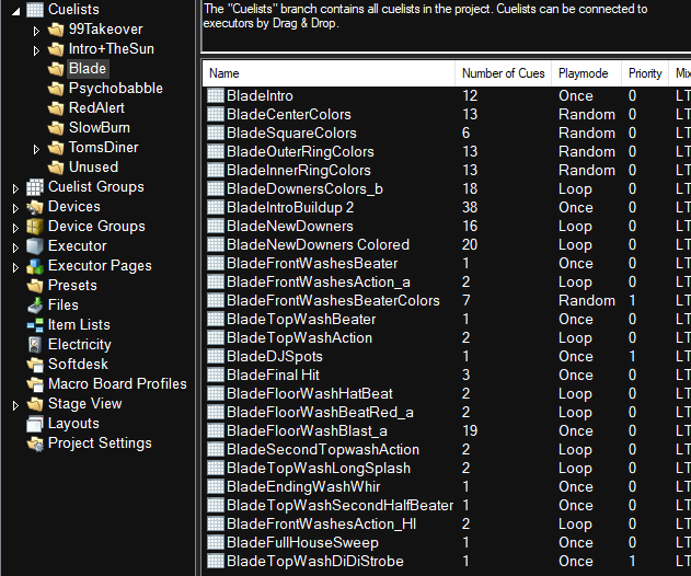

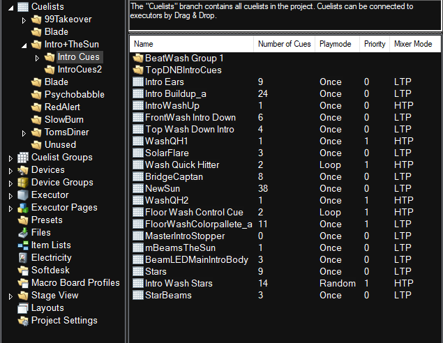

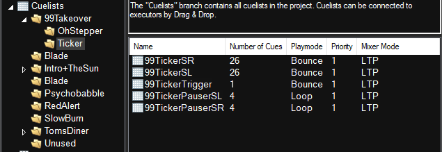

    As for the amount of Cuelists, I have attached images of the full Cuelist tree in the following replys. I will let you enjoy viewing the surface of this list haha.
    It seems the number is 154 cues total used in this demo.
    The attached Cuelist images will show how many cues are in each Cuelist down the line.
    I must add those images in 2 more posts given the image limitation of a single reply (not Spamming)
    The screenshots are also quite interesting - I see some similarities to my shows I create for our annual meeting with takes places in May (and one of them you can see at the end of our last live stream as "sneak peak").
