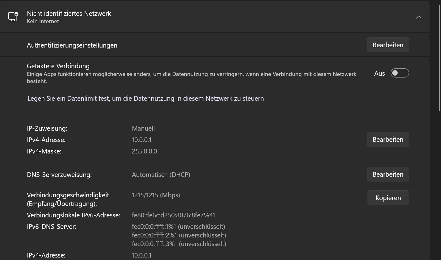

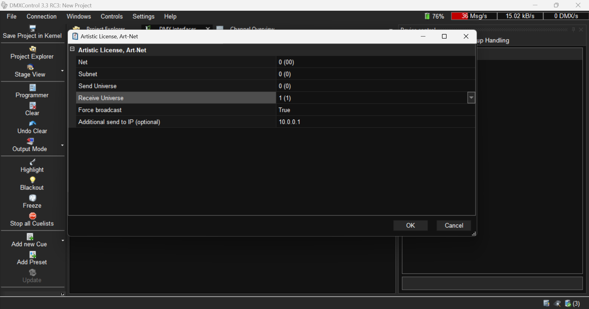

  • Hey Shween,
    thank you very much for those Informations! I will be using the method with one Pc, as I simply dont have more than one.
    So I got Pro Dmx to recognise Dmxc as a node with a virtual network adapter. I still cant get Pro Dmx to receive or send anything, but at least I made some Progress.
    Here are some screenshots I took for you, maybe you could help me through those. Otherwise I would really appreciate it, if you sent me screenshots of your configuration, as soon as you find the time to work yourself back into the program!
  • It's amazing your actually almost there. I am going to explain the 'Hidden Feature' Now to make it all work.
    I have attached screenshots as detailed as possible:
    1. First, Install Virtual Network Adapter As described in this tutorial (Click Link):
    How to create virtual network adapter in windows 11 or windows 10
    2. Once You Install the adapter, go to Start -> Type Control Panel -> In Control Panel type 'Network' -> Click on 'Network & Sharing Center'
    3. In 'Network and Sharing Center' click 'Change Adapter Settings'
    4. Find the new virtual network adapter 'Microsoft KM-Test Loopback' (I renamed mine to ArtNetLoop) -> Right Click -> Properties -> Double Click 'Internet Protocol Version (TCP/IPv4)'
    5. Change Settings as Follows -> Click OK
    6. Open DMX Control 3 (I am using v3.3.0)
    Go to Settings -> DMX Interfaces -> Add Device - Artistic License -> Art-Net
    [LEAVE ALL SETTINGS DEFAULT ('0')]
    Change 'Additional Sent to IP' to the IP Address your Virtual Network Adapter is set to.
