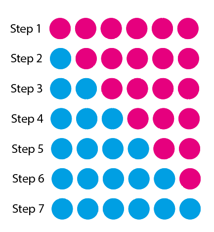

    I'm trying to create a 'cascade' colour chase across LED parcans, and was wondering if there is a way to do this using Effects rather than cue lists?
    See attached image for a visual demonstration of what I'm trying to achieve.
    Any help much appreciated!
    If it's not currently possible, can I suggest this would be a useful feature to have in a future version? I would imagine it would work as an extension of the Colour Chaser, with a Play Mode of "Cascade".

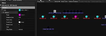

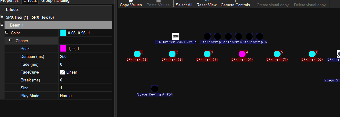

  • Hello Phil!
    You can and only need use the „simple“ Chaser by putting them on „Color“. There you can choose for the parameter „peak“ your second colour - in your example the light blue. The magenta you set directly in the color property.
    Does it work with this advice already? If not, don’t hesitate to ask again. :)
    Regards, Stefan.

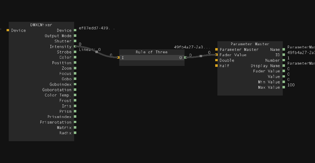

    there is a way to create this effect. However, it is one of the uglier ones, because there is currently no way to generate this effect on a direct way (as a sub-function of one of the existing effects). But you can get this effect by using the "PWM Static" effect, a ParameterMaster and a dummy device. For this, add a new generic dimmer first. This is our "controller device". Set its start address to some value, that doesn't bother you. Then open the Input Assignment and add a new connection set. In it, add a new DMXCMixer node (by right-clicking => Add => Wrapper => DMXCMixer). In its properties, select the generic dimmer and confirm with OK. Then add a Rule of Three (in the logic section of the context menu) and set its input max to 100 (because this is the maximum value, the DMXCMixer gives us at the intensity output). Maybe, you have to set the input min to 4 or 5 to have the final effect correct, but you can adjust this later, too. Last, add a ParameterMaster node and select the "ParameterMaster 1" in the Properties. Connect the "Intensity" output port of the DMXCMixer with the Rule of Three and from there connect the "Fader Value" Input port of the ParameterMaster node. You can find the resulting connection set in the following screenshot.
    Why do we need this connection? We can now control the value of the ParameterMaster 1 with the intensity of the dummy device. Now we can setup the resulting effect. Add the "PWM Static" effect to the color property of your fixtures. You will notice, that the ParameterMaster 1 is already entered as parameter for the "Deflection" of the PWM Static effect. Set the "Fade" to "False", the "Direction" to "<" and the "Peak" to the color of your choice. Set the main color parameter of your devices to the second color. Now, we came to the fun part. By changing the intensity of the dummy device, we can control the position of the separation between the two colors. So you can e.g. add a triangle effect and should now get your effect. With other effects on the Intensity property, you get other transitions.
    I hope, this short description is understandable :) If not, just ask again.

  • Thank you Stefan and JP for your replies.
    Stefan - I hadn't considered using the simple chaser effect on the colour attribute before! It doesn't quite achieve what I need because it's a chase rather than a cascade effect, but it's useful to know anyway!

  • I think I over-simplified the description of what I want to achieve :)
    JP - your solution does achieve exactly what I described in my original message.
    However, what I really want is to be able to cascade 2 or more colours across a row of devices repeatedly.
    Stefan, your cuelist solution works nicely.
    It would be great if a cascade effect like this could be incorporated in a future version of DMXC so that it could be achieved without using cuelists.
