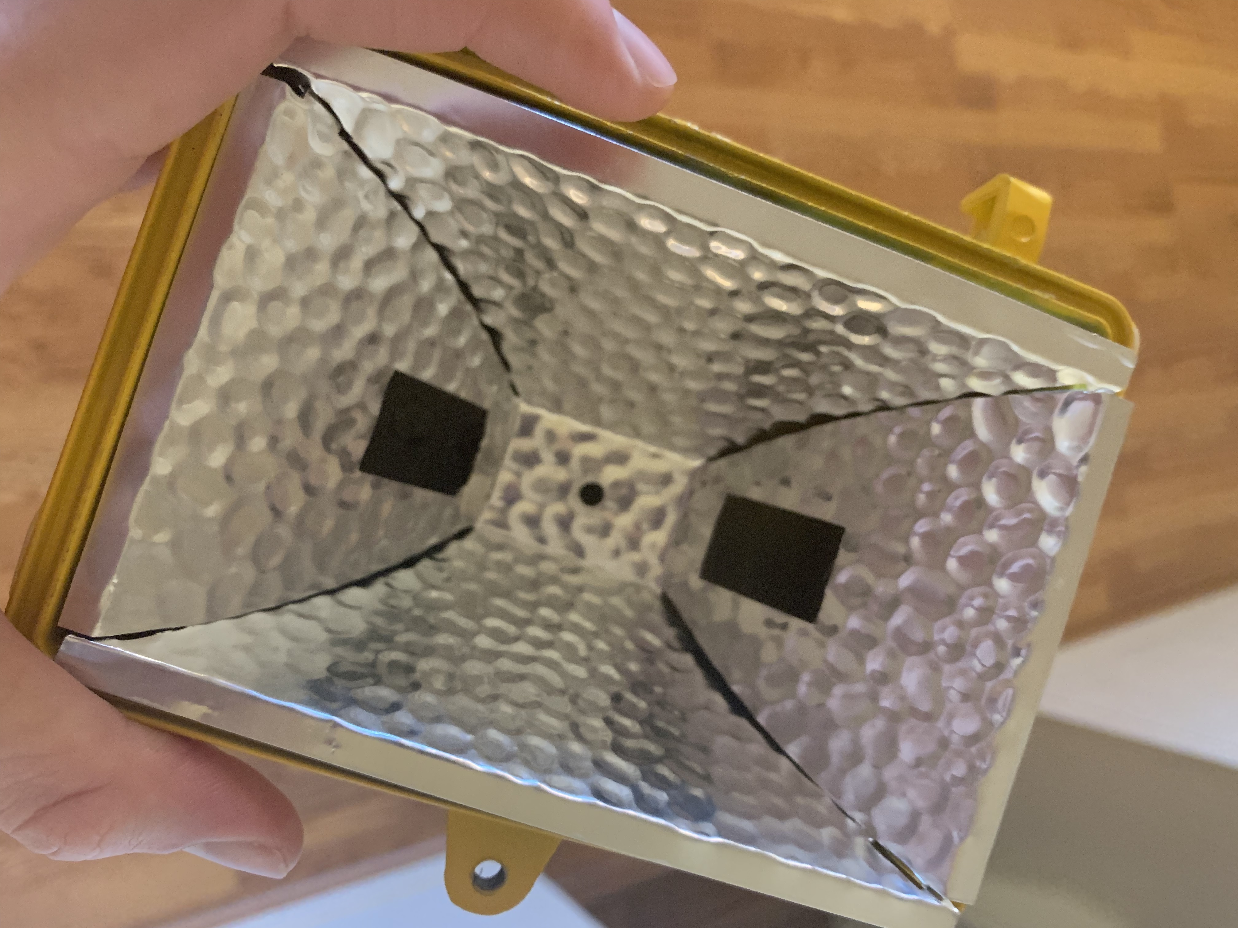

  • I’m making my own rgbwa controllers. I bought some cheap halogen work lights and took all the guts out to use as my fixture. I need a very small dmx decoder for the 5 channels so that each fixture can be daisy chained by dmx. However i have not been able to find any small 5 channel dmx decoders, only 3 channel ones. So could I use two mini 3 channel dmx decoders instead?

    Thank you. I had another question that I was wondering if anyone would be able to ask. I plan on using two of these in each fixture. https://www.mossled.com/products/modul…=15745552252987
    They’re 3 watt rgbwa modules. But do you think two 3 watt modules is bright enough to be seen?

    I need these fixtures to act as accent lights. They need to be bright enough to light up a person or prop from a couple feet away. I could try to use 3 modules in each fixture instead, which would be around 9 watts. Or even a foot each of this https://www.environmentallights.com/18370-rgbaw-5i…-specifications
    to tape around the aluminum reflector

    I could try to put some 30 degree lens on the individual leds? Do you have any better recommendations on what to use as the light source for the fixtures?

    Answering your question, normally LEDs don't have a reflector in the shape of the work Lights, the lens shape is cone shaped and you have multiple of these. I think your best try is putting 3 of these inside the housing with a 30-60 degree Lens and not use the original reflector. Nevertheless 9 Watts is still not very bright. Also the 3 Watts is per Module, which means the individual color is less. You only have 3 Watts if you run these modules on "Full On" mixing RGB and Whites.
