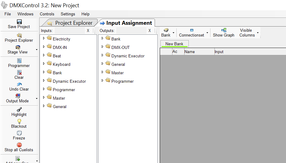

    I can't see anything for a MacroBoard branch in the Input Assignment - maybe I'm looking in the wrong place? I have attached a screenshot.

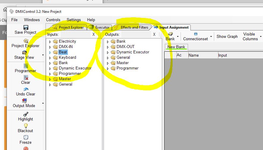

  • I backed up the folders, and uninstalled all copies (3.2 and 2.xx) on my system. Reinstalled a fresh copy of 3.2, and still can't see any instance of stream deck on the input assignment.
    I also deleted the streamdeck program and control centre before reinstalling DMXcontrol 3.2.
    I have attached a screenshot of the input assignment.

  • I have got the laptop to connect to the kernel on my desktop. The stream deck is connected to my desktop.
    Assuming that I am looking in the correct place, nothing is listed under the input assignment on my laptop for the stream deck.
