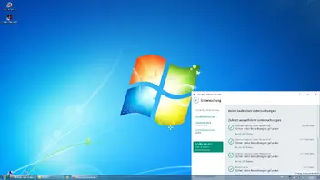

  • Hi,
    which antivirus tool do you use? We have tested this zip-file with Kaspersky (the best antivirus tool in this test https://www.heise.de/ct/ausgabe/201…er-2463396.html) and with the trendmicro antivirus tool. To be shure, I tested it again with Kaspersky. All tests declare, that the Beamertool.zip is clean and save.
    regards
  • Ok I believe you, no reasons to think there is a virus, but better to advice. I'm using Avira.
    I deactivated antivirus, and start them: both files crashed instantly. I've Win7 64 bit
    Did you download the zip and tested? The exe is only 33kb
  • Jes, I tested the zip ;) It is correct, that the beamertool only have 33kb, because it uses some Windows-Components (e.g. the XNA-Framework). So only a few functions are needed in the program and it can be very small. Just start it with admin rights (it have to write some config files). If this doesn't help, is the XNA Framework 3.0 installed on your computer? If not, then do this (you find it on the microsoft webpage https://www.microsoft.com/en-us/download…s.aspx?id=22588). With this, the Beamertool should run.

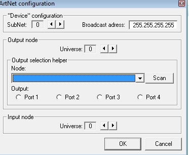

    I'm using loopback 127.0.0.1 before having any other issues with real network, Im using DMXC3 with a casual fixture, I check the output with The Art Netominator and there is traffic, according exactly what I cange in the fixture.
    I've about 11 channel in this fixture and I moved them all from 0 to 255, I didn't see any activity, yes universe 0, net0, channel1, I think all is right here, and the beamertool has the same.

  • Ok I'm running beamertool in another pc, he opens there correctly 6454, I charge inside a texture by beamerclient, on other pc im'm writing values into Artnet. I'm veryfy them, all correct, it should broadcast them, i also tried to change subnet and universe in different combinations. Beamertool doesn't react at all, new or old version the same.
    I can't press "i" on beamertool to see if receive packets because it crash, so i don't know if it can catch them
