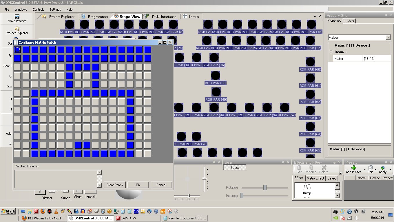

    The matrix feature is awesome! I'm looking forward to seeing the final polished version of it. But might I suggest the option of assigning positions to each pixel in the matrix? For instance, I use almost exclusively RGB par cans, primarily SlimPar's, ColorRail's and a few older LEDRain's (all by Chauvet) as well. They are positioned around the room, on the truss and some DMX controlled LED strip lights in the truss and under the tables.
    I admit I may be missing something with this, but the only way that I could figure out how to get the matrix to display the colors properly as they spread across the lights was to set up a large grid, and individually assign each pixel to the location of the light throughout the room. Please see the attached .jpg file as a screenshot of the setup. There is a fair amount of time in doing this, and while it was very functional, I wonder if being able to assign positioning, or signal delay, something along those lines might be better or more efficient? If not, or if the programming of it would be too challenging/drastic, then this system does work fine, it just takes some figuring and planning.
