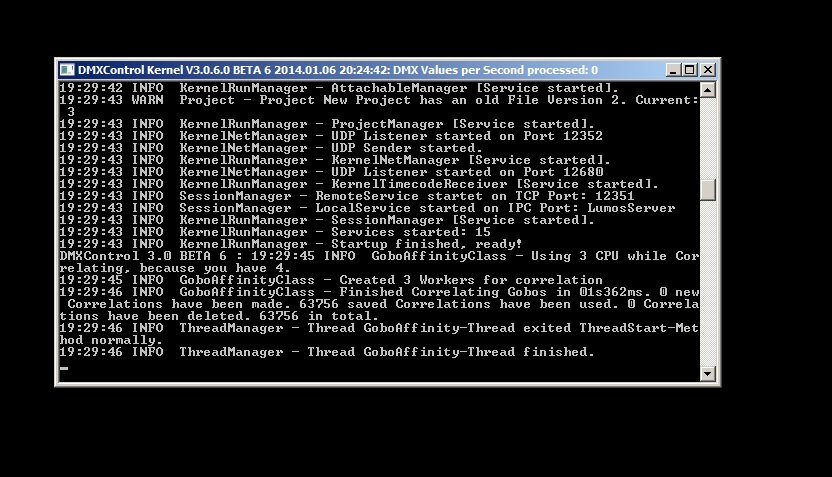

I downloaded DMXControl_3.0_Setup.exe and installed it.
What I saw is very strange. Wiki info in English about "how to" doesn`t work.
See attached files.
How can I find normal user interface?

DMXC3 has 2 different parts, a kernel and the GUI. The window in the first picture is the kernel. Now you have to start the LubosGUI.exe in the "GUI"-folder and connect the GUI with the kernel. But there is a much easyer way: Search in your windows startmenu for "DMXControl 3"=>"DMXContol 3". This will start both, kernel and GUI and connect them automaticaly.The other picture shows the manual of DMXC 3 which is not existing yet (even not in german). But there is the DMXC 3 tutorial with all informations needed ;). Just click on tutorial under DMXControl 3 in the wiki-menue on the left side.
