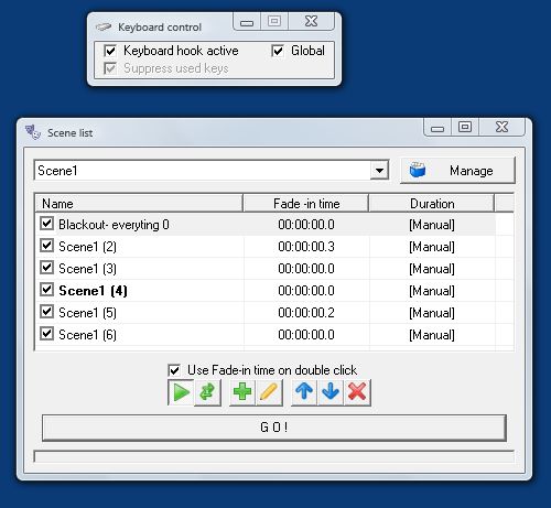

  • I think there was something confusing in Stefans text:
    you have one window for making the settings for the keys (the one with the table),
    and you have a second one for activating it. It is a small one, I have got a picture for you if you don't know it (sorry, it is only the german one). you have to test on yourself what's the best activating option for you.

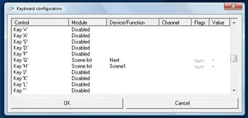

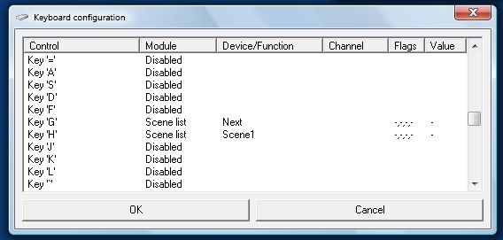

  • Thank you for the Keyboard activation window hint. I was not using it. However, I still can't use the keyboard to advance scenes. Attached are screen shots of the pertinent windows. Note that I have tried every possible combination of the check marks in the Keyboard activation windows. I have also tried capital and lower-case G.
    I don't recall reading this, but I believe you must press the green triangle button in the scene list before you can start to advance scenes using the "Go" button below it. I tried it without, just in case that was somehow necessary, but there was no difference in behavior using the keyboard.

  • I think you have to configure a "channel" in your keyboard configuration (if you have not).
    At my configuration I can't use the "GO"-button by key, but I can use the start/stop-funktion by key.
    I don't know why (and I don't understand what the GO-button is for... ^^)...

  • On a lighting deck, the "Go" button is what tells the console to start the next cue that was stored in memory. I.e. "Go to the next cue".
    Yes, it was the "Channel" setting that was missing. If I set my keyboard window to;
    Control | Module |Device/Function | Channel | Flags | Value
    Key 'G' | Disabled |Next | GO! |-,-,-,- | -
    Argg.... it seems that the message board ignores multiple spaces, so I can't format the table above to line up.
    Pressing "G" on my keyboard will cause the scene to jump to the next one. However, I am still puzzled about the settings. I would have thought the "next" and "GO!" meant the same thing. I have no idea what the flags or value fields are. I also cannot figure out what to set to make it go back one scene.
