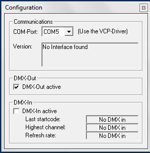

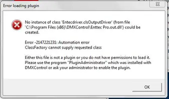

    I downloaded and installed version 2 of DMXControl. Then, I re-ran the vbctrls registry file you linked to ealier. DMXControl did not give an error message when it was started, but the interface didn't seem to run either.
    So, I copied the new Enttec Pro.out.dll file over the existing one in the program directory, and re-ran DMXControl. The error message attached below came up. I went past it, and tried to use it, but there was no DMX output. I have also attached a screen shot showing the details of the configuration. Note that the settings screen showed the same thing on both attempts. Also, I looked at my device manager to see that the device is connected on COM5.
    -Joe Dunfee
    First, thank you for your attention to this problem.
    I had uninstalled both versions of DMX control a few months ago, when I couldn't get them to work. So, for this new round of tests, I installed the Version 3.0.1.2 beta 1, and then ran the vbctrls.reg file as you requested.
    However, when I attempted to install the Enttex DMX USB Pro interface, Enttec brand was not listed. I searched the entire program directory for anytyhing with "enttec" and nothign was found.
    Then, I placed the Enttec Pro.out.dll file in the same directory where the other brands are located. C:\Program Files (x86)\DMXControl3.0\Kernel\Plugins. I restarted DMX Control 3. However, again, the Entec brand interface did not show up.
    -Joe Dunfee
    That link is to a message that has the file, Enttec Pro.out.dll.pdf. However, when I attempt to open that PDF, I get the message from Adobi Reader that it is not a PDF file. Is this file intended to be an Adobi PDF? Should I rename it to remove the ".pdf" part, so that it is named Enttec Pro.out.dll ?
    Then, if the file should end with .dll, what do I do with the dll file?
    [edit... I used a translation site, and yes, it looks like you must remove the .pdf. It was added because apparently uploading a .dll is not permitted. But, I still don't know what to do with the .dll file. ]

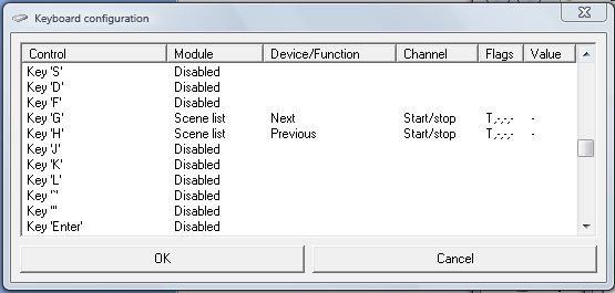

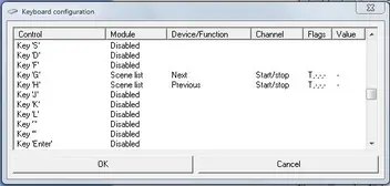

    Okulus, thank you very much for your effort. Even though my program is in English, I have attempted to copy your Keyboard Control window. However, my version does not behave the same as yours.
    When I press G , a scene I have highlighted will play, (or stop if I press G the second time I press G. But, it will not advance to the next scene.
    If I press H, then has the exact same behavior as when I press G.
    Attached is an image of my Keyboard Control window.
    Joe Dunfee

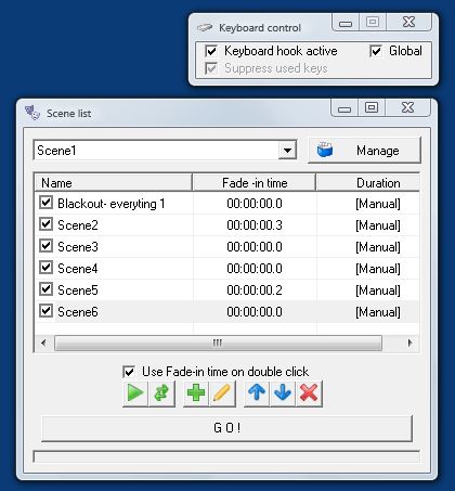

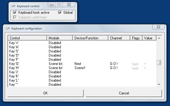

    I have had some limited success. I have been able to run a PowerPoint presentation, and simultaneously go to the next lighting cue. The set-up is as follows.
    + Re-map the Page Down key to the letter G.
    + Run DMXControl with the Scene List window open with the play button pressed AND have also highlighted the first scene (got stuck for a while by omitting that last step).
    + The small version of the keyboard control window is open.
    + Then I minimize DMXControl.
    + Run PowerPoint in 2-window mode (i.e. presenter view on laptop, and the external monitor shows the slides full screen).
    With this all set-up I can press the Next Slide button on my remote, and both the PowerPoint slide and Scenes will advance.

    Sorry, but it seems I am not understanding the "Keyboard Control" window. The English help file has no explanation. In the past, I got it partially working, but after making some changes, none of the keyboard commands work. Note that I am not using the remote or Auto Hot Keys at this point, I am just trying to get the physical keyboard to work because I know it must be working before I can get the remote control working. I know you posted about it in the past, but something is still not right in my configuration and I can't figure it out. Attached is a screen shot of my current settings.
    After these settings in the "Keyboard Control" window are done, I click OK and the window goes away. The small "Keyboard Control" window stays open, and I keep it open because it needs to be open in order for DMXControl to receive keystrokes.
    Also the scene list window is open. I press the green triangle "play" button to start the show. If I press the "GO" button on the bottom of the scene list window, it functions normally, and will progress to the next scene in sequence. So, at least I understand how to make a list of scenes.
    Can anyone tell me what might be wrong with my keyboard commands?
