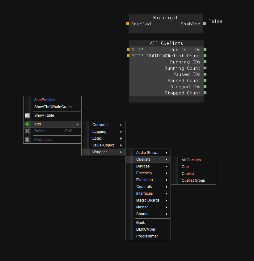

    technically, you can do that via the Input Assignment. Add a Connection Set and doubleclick it. Then, add the "All Cuelists" Node for the second one. The first one is a little bit trickier and there are multiple ways to achieve this. But they depend on the result you want to get. So what do you planing to do with that?

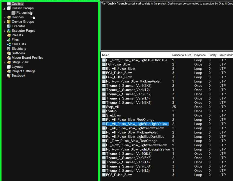

  • That's pretty neat! Basically, I have an installation with a group of LED fixtures as it's main group. They are turned to full white in the morning and turned off at night. During the day, they are controlled with different looping cuelists. The duration of how long these looping cuelists run for is controlled from an external computer via DMX. My issue is I'm not sure how to turn them to a certain color using a normal cuelist and keeping them that way until another cuelist is called. So right now, I'm manually highlighting the fixtures in the morning. When a looping cuelist runs and times out, a cuelist is called to 'Stop and Release' all looping cuelists.
    I'm basically looking to automate the highlight function and replace the Stop cuelist with a better solution.

    Ok, I looked into your project and hope, I understand your post correct. If not, please correct me :) You need a way to stop a cuelist, if another one starts to run and you need a sort of highlight function to keep the lights on and only change the color. Is this correct? If yes, then I would do the following: First, add a cuelist, which is only responsible for the dimmer of the devices / device groups. So this cuelist contains only one cue with the respective dimmer values in it (full on). This cuelist will run the whole day until you or the external computer stops this cuelist. The second change in your project is the one, where the magic comes in ;). DMXControl 3 uses the concept of cuelist groups. A cuelist group links the containing cuelists and controls their start and stop behavior. You define those groups in the Cuelist Groups folder in the Project Explorer. In the setting of a cuelist group, you will find the "cuelist start behavior", which is the one you need. If you select "Single List Running", DMXControl 3 automatically stops all running cuelist in the group if you start another one in this group. So just add all cuelists, which shall inhibit each other (so in your case e.g. all "PL_..." cuelists). This can be done by drag&drop the respective cuelist onto the cuelist group in the left tree view (see the following image)
    Then you just need to trigger your "Theme_..." cuelists as you already do to start the correct cuelist and DMXControl 3 do the stopping by itself. So you do not need the "stop all cuelists" command anymore :)
