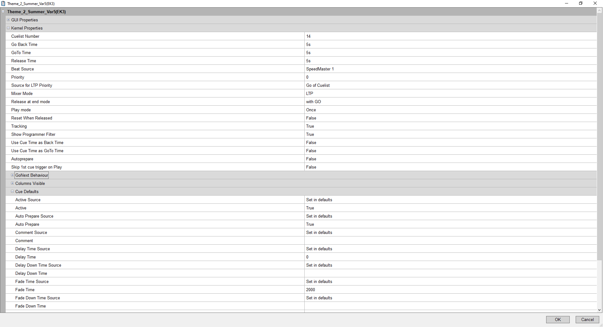

    I've attached the project and a screenshot of the configuration of a typical cuelist (all are pretty much identical to this). The connectionset doesn't fit properly in an image since its multiple connections. The setup is designed with the following operation in mind:
    - There are two PCs, PC1 manages DMX triggers that go into PC2 and PC2 runs DMXC3
    - PC1 starts a show which runs for say 10 minutes; it triggers one or more cuelists in PC2 at the start of a show and it send DMX triggers to reset them at the end of a show
    - DMX input 4 resets all the cuelists (for example at the start of the day or at the end of a show)
    - DMX input 1 turns all lights off (only used at the end of the day)
    I'm not sure if the cuelist configuration is correct, any help or advice would be much appreciated.

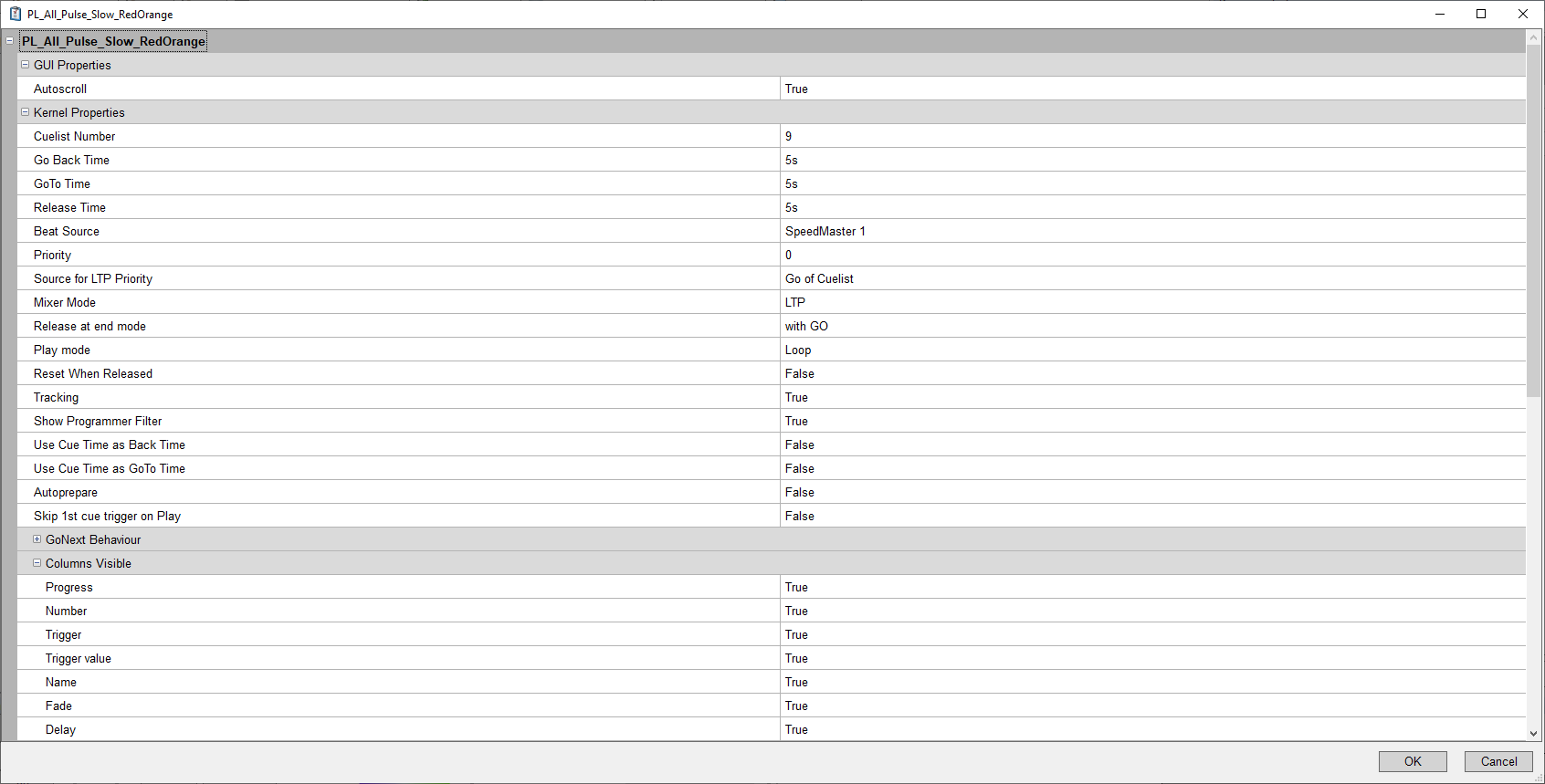

    Hallo,
    I've created a few looping cuelists to fade between two colors. I have two follow cues each with a fade time of 5s. The light type is the default RGBW that DMXC3 has. I see an occasional fast flicker during when the cuelists run and I'm not sure if there is a setting that is causing this. My basic cuelist settings are attached. Any thoughts would be very much appreciated.
    Cheers!
