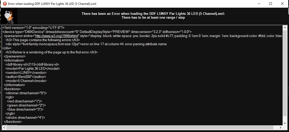

Hi,
A few months ago, someone on this forum made a DDF Library file for my lights. I have no idea how to code and this file has not worked. I was wondering if someone would be willing to write a new one for me. The old file would turn my lights red and I could not control them in any way; I will leave the code down below and the channels. The last 2 channels are unimportant, so if it is difficult to code its not a big deal.
The lights are a 7-channel system and I bought them off of amazon.
LUNSY RGB Stage Lighting 2Pack, 36LED Dj Par Lights, Uplighting for Events, Sound Activated,
Thanks so much for your help!
-Trevor
