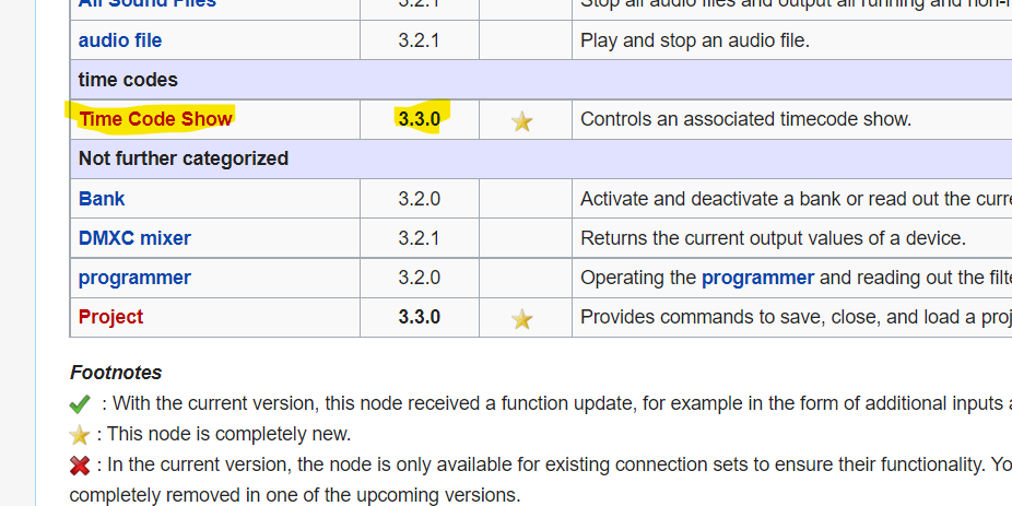

    From what I have read, timecode is an input which will be introduced in DMXC3.3. ( https://wiki-de.dmxcontrol-projects.org/index.php?titl…ssignment_DMXC3 )

  • From what I have read, timecode is an input which will be introduced in DMXC3.3. ( https://wiki-de.dmxcontrol-projects.org/index.php?titl…ssignment_DMXC3 )
    With version 3.3 we will introduce the so called timecode player, which can play audio files, cuelists and others in the way a video editing software / DAW works. There you can start and stop at any point in the audio file. For a little sneak peak, we showed an early version view in the following video:
    External Content youtu.be
    However, the 32-bit problem Beni200 described is valid for this too. We are working on the 32-bit issue as well, but we can not say, if we can fix it already in the 3.3. An external timecode input is currently not available and we are currently not working on it. This will maybe part of a future version.
