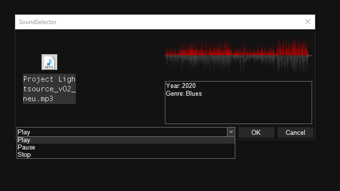

  • Yes, there is a way to do something similar. With V3.2.2 you can already load MP3 files into DMXControl 3. For this, open the project explorer and open the folder "Files". Do a rightclick in the right area and click on "Open File...". Search the audio file on your file system and add it. After that, go into your Cuelist and click on the small arrow on the "Add Cue" button. In this menu, there is a sub menu with special cues. There is a menu entry to add a command to control the audio file. There are commands to start, stop or pause an audio file. After inserting this special cues, you can add your normal light cues and change the trigger of them to timecode. Now set the timecode value accordingly. This will trigger the cues, if the audiofile has reached this timestamp.
    However, the audio file runs beside your cuelists so it can not be part of a cuelist itself. This fact is important to know, because the special cues only trigger the start or stop an audio file. Thus, the audio file will keep running if you stop the cuelist. This is one of the major drawbacks of this solution.

  • Hi, there is a stop command in the special cues. You have to add this command as a second special command at the end of your cuelist or in a separate cuelist. It allows you to stop the audio.
