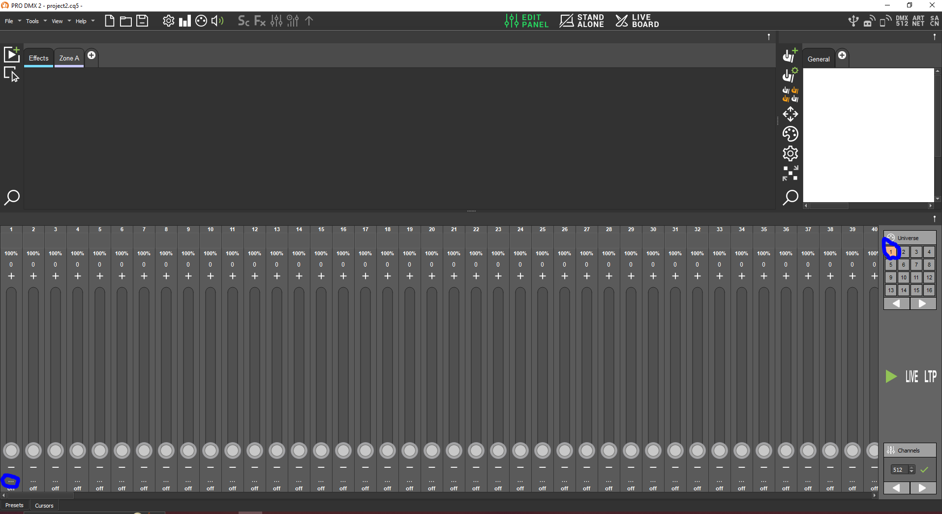

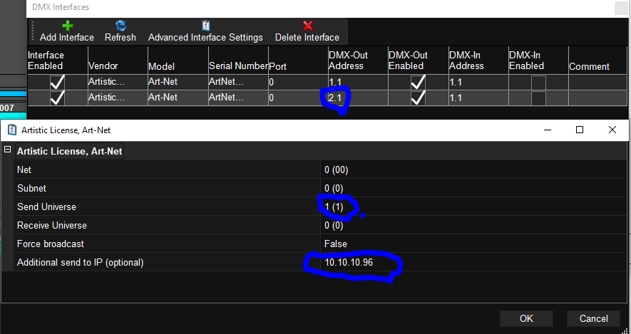

    To add additional universes in Pro DMX 2 (Up to 4) Follow these Steps.
    1. Add another Art Net Device in DMX Control 3. Change the Settings Circled in Blue.
    2. In Pro DMX 2, click 'Universe 2' and click on the 3 dots on channel 1 and enter the same settings as before, but just make sure to select universe 2.
    3.Follow the same steps for Univers 3 and 4 respectively.
    And it should be as 'Simple' as that!
    Let me know if you are able to make this work!

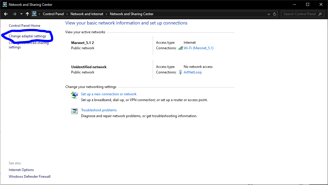

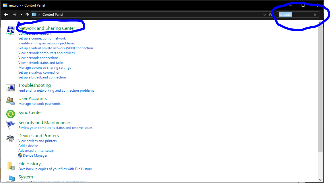

    2. Once You Install the adapter, go to Start -> Type Control Panel -> In Control Panel type 'Network' -> Click on 'Network & Sharing Center'
    3. In 'Network and Sharing Center' click 'Change Adapter Settings'

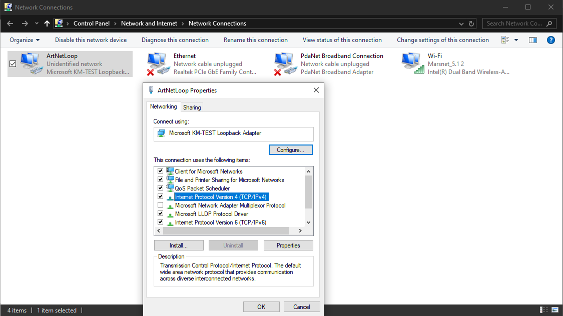

    4. Find the new virtual network adapter 'Microsoft KM-Test Loopback' (I renamed mine to ArtNetLoop) -> Right Click -> Properties -> Double Click 'Internet Protocol Version (TCP/IPv4)'
    5. Change Settings as Follows -> Click OK

    Go to Settings -> DMX Interfaces -> Add Device - Artistic License -> Art-Net
    [LEAVE ALL SETTINGS DEFAULT ('0')]
    Change 'Additional Sent to IP' to the IP Address your Virtual Network Adapter is set to.

    8. Now for the Hidden Part. Click the Check Mark at the bottom and you will see this screen.

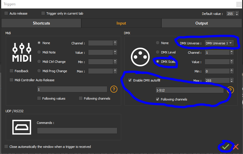

    Make Sure you are in universe 1 (On the Right) -> CLICK THE 3 DOTS AT THE BOTTOM OF THE FIRST FADER
    9. In this Window, Copy the Following settings exactly and hit Checkmark. [Only Adjust Setting Circled in Blue]
    10. You should now be controlling ProDMX2 Faders from DMXC!
