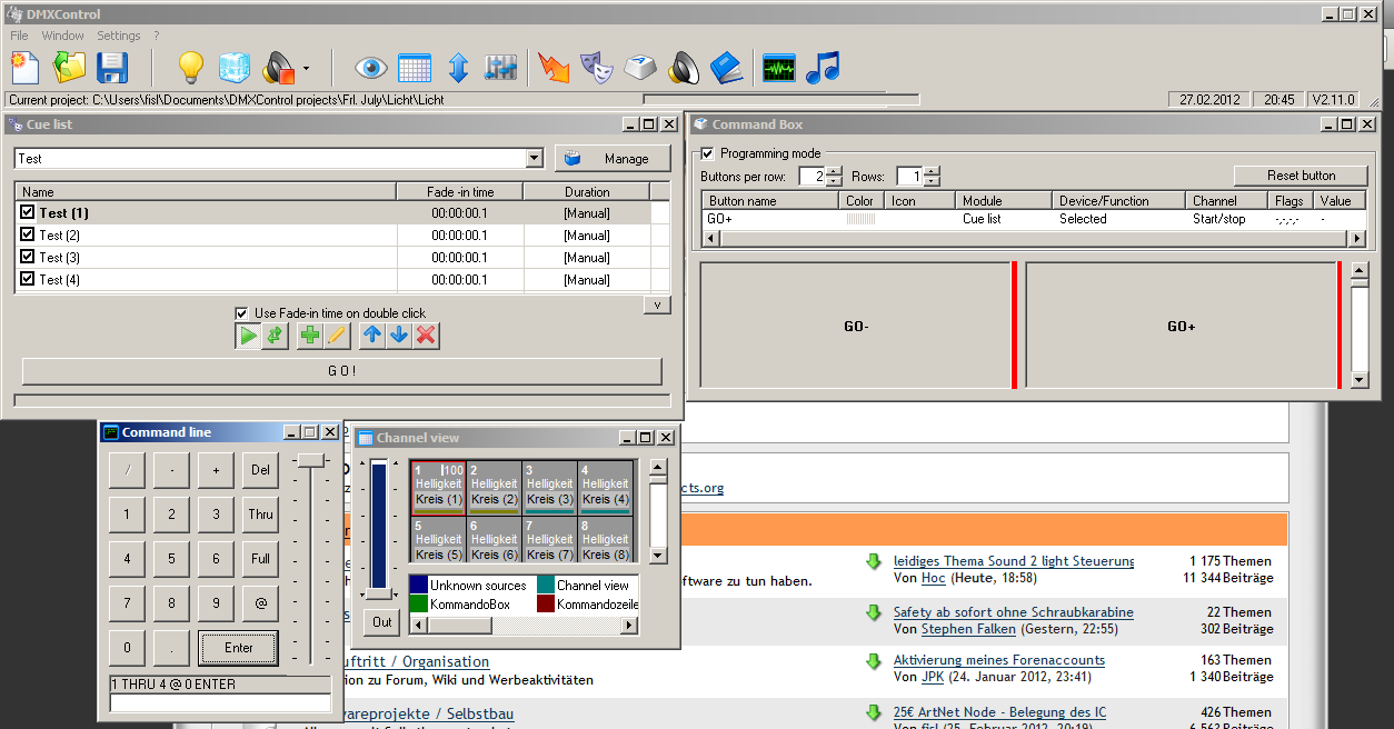

    1: I am trying to create a control area which houses a go and back button to run my cues, How do i create a button in the command boxes which will go back to a previous cue, i have found the edit menu for the command boxes that allows you to choose cue list>previous> go, but this just makes each of my cue execute as if the button i created were a go button (they go forward, not back)
    Sorry, but at least the actual Version of DMXControl does not support a "GO-" oder "GO back" possibilty. What you found is the function to switch through your lists if you have more than one cuelist. Thats why the function labels "previous (cue list)". Dont mess it up with "previos entry/scene/position/cue".
    So I don't know a solution for that.

  • 1: I am trying to create a control area which houses a go and back button to run my cues, How do i create a button in the command boxes which will go back to a previous cue
    As Hoc said it's not possible. I'd say the cuelist is the part of the program where some important features are missing. At least if you are used to work on consoles.
    If you want to go back to a cue, you must select the cue in the list and then press the "play icon" twice (left icon).
    You can bind this command to a button in the command box. So the workflow would be: Select the cue you want to goto and then use the button in the commandbox.
    Unfortunately there is no direct possibility to go one cue back.
    If you use tracking (only record changes) there is absolutely no way of going back, beacuse only the content (the changes) of the cue you goto will be played back. So the look on stage isn't the same it would be if the list had run in sequence.
