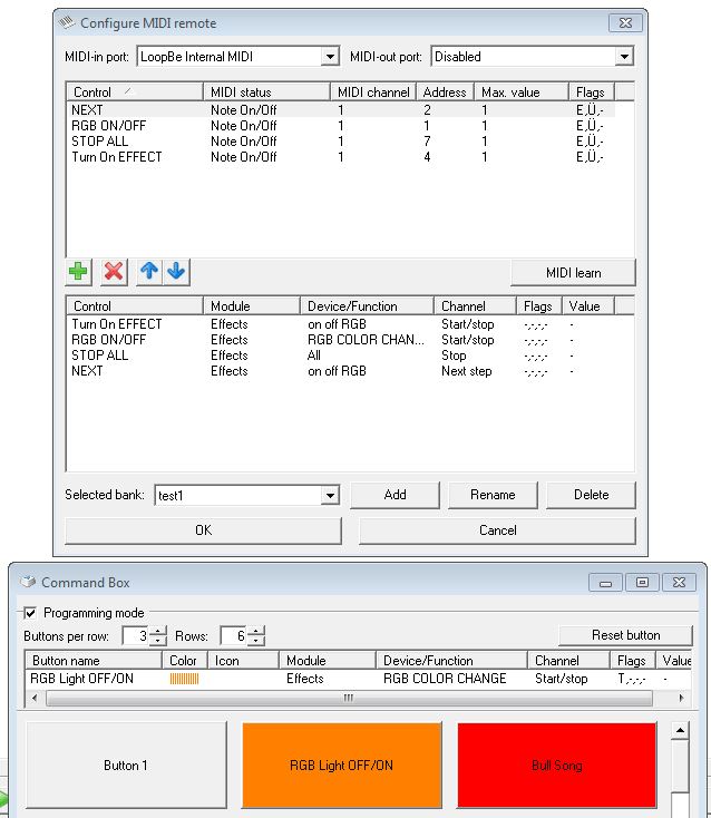

    That makes sense Stefan and I thought it was something like that. The web interface software I am using to create the midi signals does allow you to sing a string of midi commands but when I send both of them it does not work and can not create a delay between them.
    Sending two commands got me thinking and I found another method that should always work and you don't have to make sure the effect is playing like I was doing before.
    What I did is create a 3 step effect like this
    Web Toggle
    Chasers->RGB Color Change -> Start (Duration Manual)
    Chasers->RGB Color Change -> Stop (Duration 0)
    Chasers -> Web Toggle -> Stop (Duration 0)
    And then I create two of the same MIDI Controls
    RGB Button -> Note On/OFF -> 1 -> 1 -> 0 -> 1
    That will trigger) Chasers -> Web Toggle -> Start
    That will trigger) Chasers -> Web Toggle -> Next Step
    And it works perfectly! So if the effect is stopped, it will start it and it will also send the next command so if the effect is currently playing it will go to the next step which stops itself.

    I have been playing with DMXControl for a few weeks now and really impressed with what you can do. At this time I have having some problems trying to get MIDI to control DMXControl correctly.
    I have been able to mostly get DMXControl to respond to basic MIDI commands but having a problem triggering a START/STOP command to an effect.
    For example in Command Box I am able to make a button by Selecting EFFECT/DEVICE/Start/STOP TOGGLE ON. I can push the button in the Command box and the effect will turn OFF and ON.
    I can not make this same command work in the MIDI remote box. Sending a Midi Command of 1/1/1 (Midi Channel/Address/Value) using the same command as above will START the effect but sending it again will not STOP it. It does not matter if the toggle flag is ON or OFF.
    To turn the EFFECT OFF I have to send a Midi Command of 1/1/0 (Midi Channel/Address/Value which means i have to send two different MIDI commands depending if I want it ON or OFF. What I want to do is create a single MIDI command that will toggle the EFFECT to START and STOP, just like I can do with a button in Command Box.
    To get around this problem what I am having to do is create a new effect that has two Steps with the first Step Starting the effect and the second step stopping the effect. I then configure both steps to "Manual" and then use a midi command to just step to the next step and the effect is on repeat. This is kind of pain to do it this way and you have to make sure the effect is running.
    Any help would be appreciated to somehow send one MIDI command and have it toggle START/STOP on an effect.
    Thanks.
    -Richard Holdman
    https://forum.dmxcontrol-projects.org/www.holdman.com/christmas
    Below is a screen shot of my MIDI remote box and Command Box.
