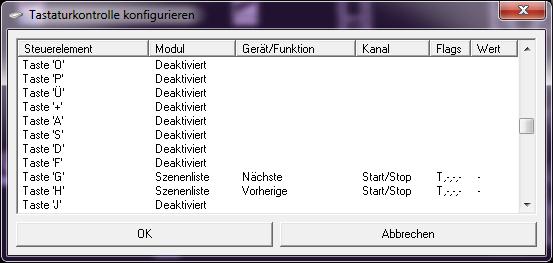

  • Hello Joe,
    your machine translator is quite amusing :) , it was easier to understand your original text.
    I don't know anything about AutoHotKey and how you manage to send keystrokes; but if it works, try the following:
    I use "G" and "H" because they are near together and so I can show it in one picture. If you like to use "B" it should be no problem.
    In key control you have to select G, then under Modul -> Szeneliste. In Gerät/Funktion Choose Nächste = next, in Kanal Start/Stop, in Flags -> Umschaltmodus (Toggle). For "H" mostly the same, except Gerät/Funktion Vorherige (previous). Close with OK.
    Then you have to activate the Key control = Tastatursteuerung in the second tab from rightside in German "Fenster".
    A little window is opening. Make a hook in Tastaturabfrage aktiv, don't close it, just minimize it.
    Activate the window "Grafische Bühnenansicht" = grafical stage view or similar. Now hit G and the first scene starts. The next keystroke on G will stop the scene, another one will start the following. Allways stop a scene before initiating anything else. Otherwise both or more scenes will interfere. With "H" you go to the previous scene.
    In my system it works well, I hope it will bring you to success as well.
    Bye for now
    Okulus (Werner)

  • Okulus, thank you very much for your effort. Even though my program is in English, I have attempted to copy your Keyboard Control window. However, my version does not behave the same as yours.
    When I press G , a scene I have highlighted will play, (or stop if I press G the second time I press G. But, it will not advance to the next scene.
    If I press H, then has the exact same behavior as when I press G.
    Attached is an image of my Keyboard Control window.
    Joe Dunfee
    Maschinelle Übersetzung;
    Okulus, ich danke Ihnen sehr für Ihre Bemühungen. Auch wenn mein Programm ist in Englisch, habe ich versucht, Ihre Tastatur-Fenster zu kopieren. Allerdings ist meine Version nicht so verhalten haben wie Sie.
    Wenn ich G, eine Szene, die ich hervorgehoben spielen wird (oder zu stoppen, wenn ich G zum zweiten Mal drücke ich G. Aber Presse haben drücken, wird es nicht in die nächste Szene vor.
    Wenn ich H drücken, dann hat das exakt gleiche Verhalten wie wenn ich drücken Sie G.
    Beigefügt ist ein Bild von meiner Tastatur-Fenster.
  • Hi Joe,
    I am using version 2.11 beta under Windows 7/64. Tomorrow I will run a test under XP on another machine with the current version 2.10.6.
    It sounds good that it starts with G and stops with the second stroke on G. The 3rd should start the second scene of your list, the 4th stops it. H will change to to the previous scene. A second stroke on H will stop the current scene. That's the way it works on my system.
    One point: It's playing the scenes in your scene list; There should be more than one scene; if you are standing at the end of the list it behaves like you describe; then H should work to start the previous scene.
    Good Luck and bye
    Okulus

  • Hi Joe,
    the problem is, that you can only switch between scenes, and not from a part of scene to the next part. You have created scene1, which contains 6 parts; instead of that you should create 6 scenes, each with only one part (item). Then you can move forwards and backwards.
    Within a scene you can move from part to part (only forwards) with Go!
    Module is set to Scene list, Device to "Ausgewählte" = choosen or selected or similar, I don't know what is used in the english version; Channel is set to Go!, Flags = no flag or try T. Open your scene list window, select the first part of your scene; then go back to the grafical stage view window. Now you should be able to move from part to part, but there is no way back by key. You have to select again the beginning with your mouse.
    I guess the way with 6 single part scenes will be better for you !
    I hope this will bring you on the way.
    Regards Okulus
