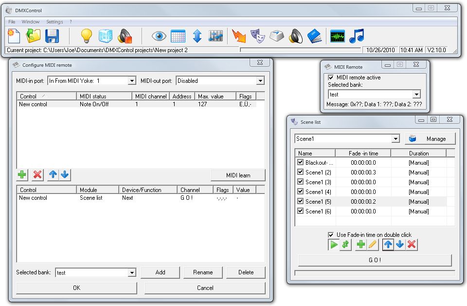

    Then, by simply having Power Point play that MIDI file, it would trigger DMXControl to go to the next scene. I have read the English PDF help file about MIDI control. I think I have every thing set up, but it is not working. The MIDI Remote window does not seem to show any MIDI data being received. Attached is a screen shot of my DMX Control windows.

  • First thing is, Address has to be 0 (Configure Midi Remote).
    Everything else looks as it should.
    Are you sure you selected Output to Midi Yoke 1 in PowerPoint?
    You can use MIDI-OX to play the midi file and monitor the results. Then try to do the same with PowerPoint an use MIDI-OX to see what was send thru Midi Yoke
    Midi Remote then should show the last incoming message.
