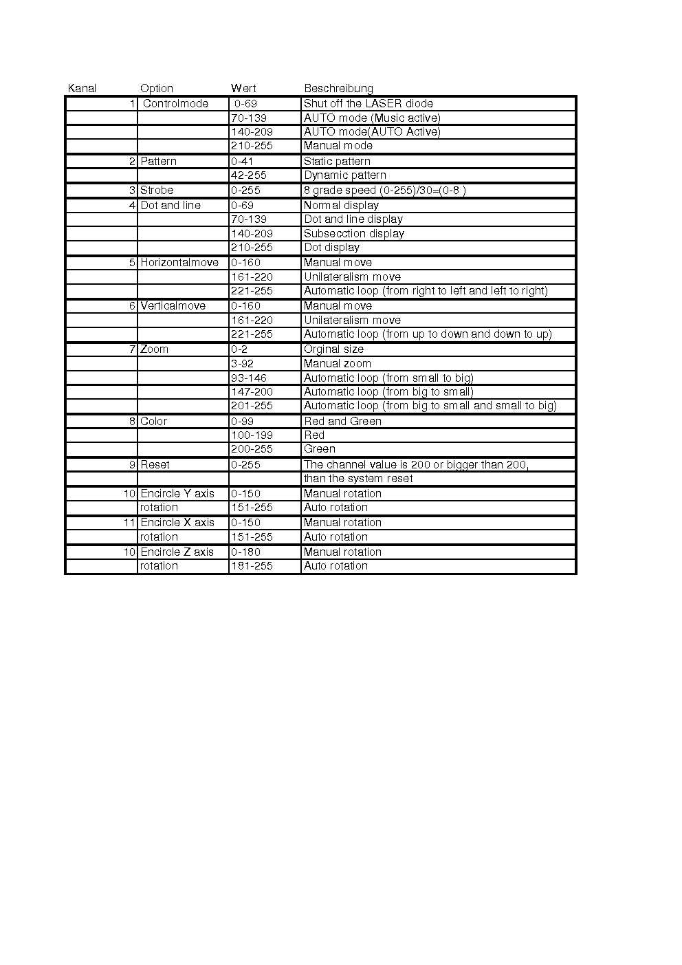

  • Könnte jemand von euch mir für das Gerät eine Geräte Datei machen damit ich die ins DMXControl einfügen kann.
    Gerät: RUIQI RD-350
    9 DMX Kanäle sind ausgeschrieben und folgende Tabelle dazu
    1 | Controlmode | 0-69 |Shut off the LASER diode
    | |70-139 |AUTO mode (Music active)
    | |140-209 |AUTO mode(AUTO Active)
    | |210-255 |Manual mode
    2 |Pattern |0-41 |Static pattern
    | |42-255 |Dynamic pattern
    3 |Strobe |0-255 |8 grade speed (0-255)/30=(0-8 )
    4 |Dot and line |0-69 |Normal display
    | |70-139 |Dot and line display
    | |140-209 |Subsecction display
    | |210-255 |Dot display
    5 |Horizontalmove |0-160 |Manual move
    | |161-220 |Unilateralism move
    | |221-255 |Automatic loop (from right to left and left to right)
    6 |Verticalmove |0-160 |Manual move
    | |221-255 |Automatic loop (from up to down and down to up)
    7 |Zoom |0-2 |Orginal size
    | |3-92 |Manual zoom
    | |93-146 |Automatic loop (from small to big)
    | |147-200 |Automatic loop (from big to small)
    | |201-255 |Automatic loop (from big to small and small to big)
    8 |Color |0-99 |Red and Green
    | |100-199 |Red
    | |200-255 |Green
    9 |Reset |0-255 |The channel value is 200 or bigger than 200,
    | | |than the system reset
    10 |Encircle Y axis |0-150 |Manual rotation
    |rotation |151-255 |Auto rotation
    11 |Encircle X axis |0-150 |Manual rotation
    10 |Encircle Z axis |0-180 |Manual rotation
    |rotation |181-255 |Auto rotation
    Habe die Tabele auch noch mal als JPG Angehangen
