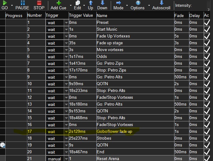

    I've noticed a cuelist behaviour that seems incorrect, but I just want to check that it's not intentional before I report it as a bug.
    I have a cuelist (we'll call this the master cuelist), and within that cuelist, I am triggering some other cuelists (we'll call these sub-cuelists) using the 'Go' and 'Stop' special cues.
    If I use the 'Go to' function to jump to a later point in the master cuelist after I have triggered a 'go' and then a 'stop' on a sub-cuelist, that sub-cuelist remains playing when I believe it should be stopped.
    Is this behaviour of DMXC3 deliberate, or is it a bug?
    So in this example above, if I "Go To" cue 17, I would expect the 'Petro Alts' and 'Petro Zips' cuelists to be stopped, but instead they are running.
    If I play the cuelist from the start, they behave as expected.
    If this behaviour is intentional, can you explain the thinking behind it so i can understand why it happens.
    Thanks,
    Phil
  • I dont think this is the wanted behaviour, but dont quote me on that. Id reccomend creating a ticket on the bugtracker.
    Usually, the go to function should be used very rarely. Because each cue builds up on the previous cue (unless tracking is disabled, which is not a preferred workflow in DMXC), a cuelist should almost always be run sequentially. What is your workflow? (when are you using go to?)
  • I only use Go To when I'm programming, not during shows.
    Most of the cuelists that I create are timed to music with many 'Wait' cues,
    So in the example above, if I wanted to edit cue 17, I would use 'Go To' to jump to cue 17, so that I could see how the lighting looks at that point without having to wait for ~2 minutes for the cuelist to play, and then 'Edit in programmer' to make the changes to cue 17, then update.
    I'll create a bug ticket :)
