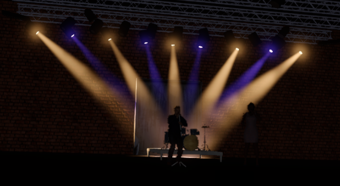

    • I have 9 fixtures for my back lights, trad projectors with only dimmer control
    • All fixtures have DMX channel, I can control each one
    • I created a device group
    • and I'm using a chaser effect with bouncing in order to have the following sequence:
      • first beat: first fixture full light,
      • second beat: first fixture off and second fixture (blue one) full light,
      • third beat: second fixture off and third fixture full light,
      • ... classic chaser
