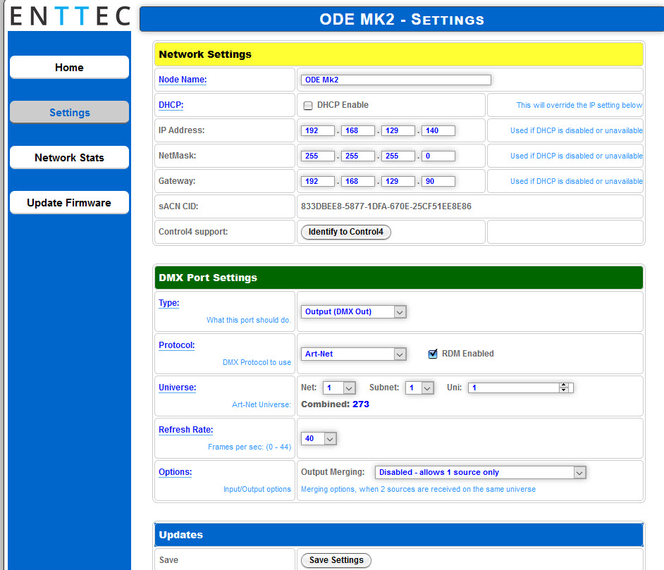

  • I am hoping someone can help me with what I think is and ArtNet question. I am using DMXControl 3.2.2 and an Enttec ODE Mk2 interface. I have this working fine with Vibrio (iPad) but I am finding that I have some inconsistencies in behaviour when I try to use DMXControl to control my devices. The symptoms are that I get some random behavoiurs on the devices I am using.

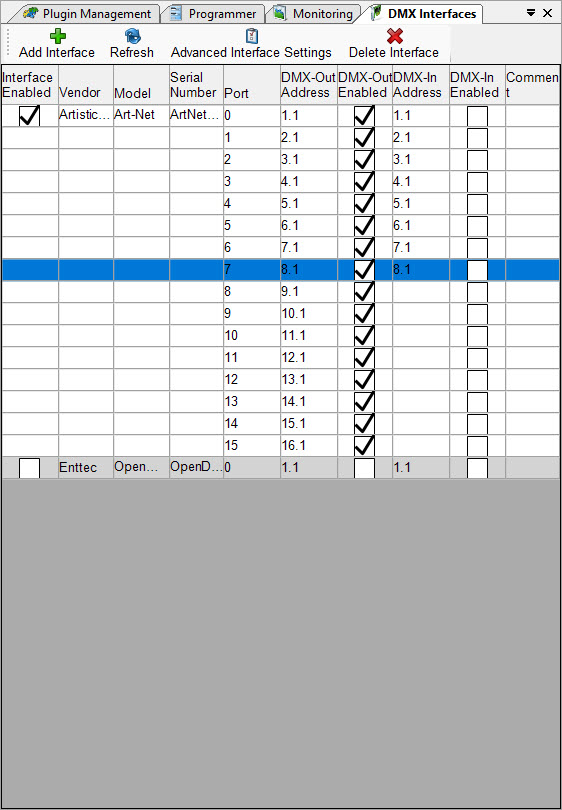

    I added ArtNet by adding DMX Interface and using the 'Artistic Licence' ArtNet option. I do seem to be able to control the devices but they time out and have random transient effects. (It affects both my DMX devices and as said they behave fine under Vibrio. (yes I have shut down the vibrio when it is not in use.

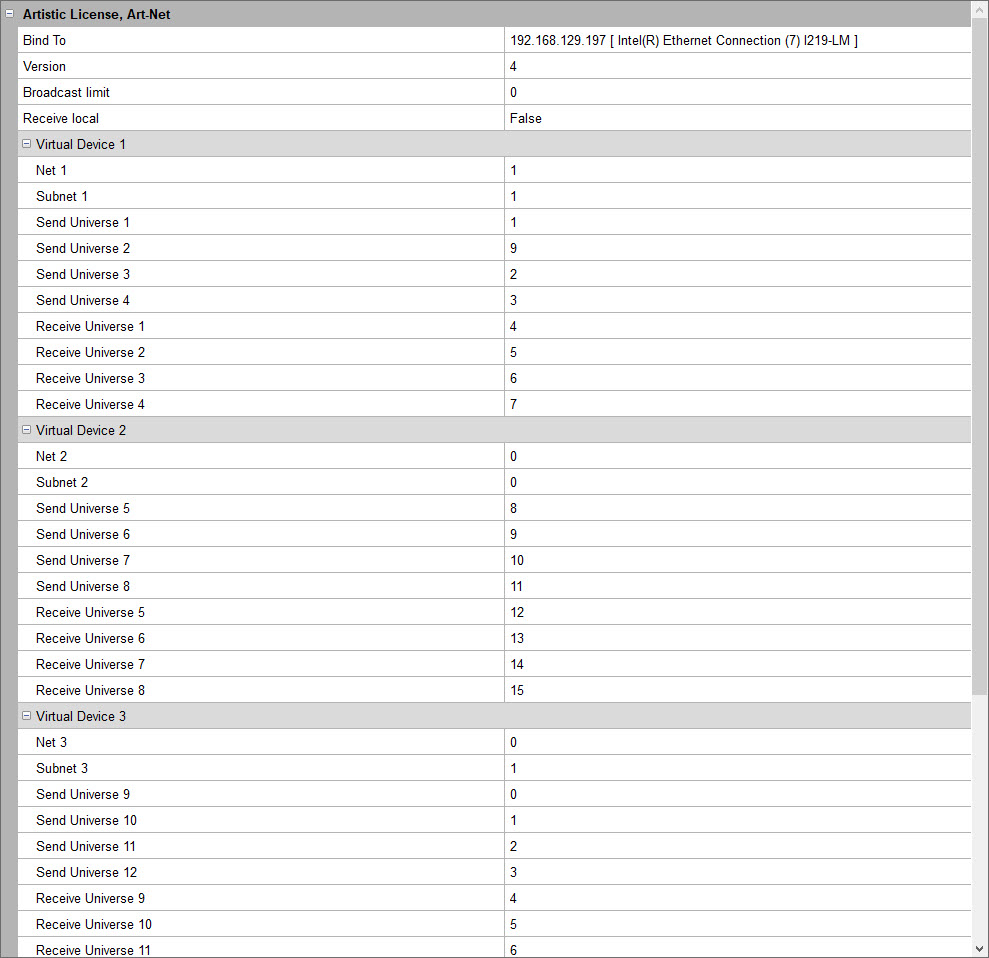

    I note that in other configurations there are options to configure the IP address of the Ethernet interface for info I attach the settings from within DMXControl. Can anyone advise a solution? (There is comment saying don't buy the cheapest interface, and I thought that Enttec would be fine.
    DMXControl 3 works with the respective ethernet interface, detects your artnet nodes and send multicasts / broadcasts to all artnet nodes in the network. Thus you only have to select the IP address of the respective ethernet port of your pc.
