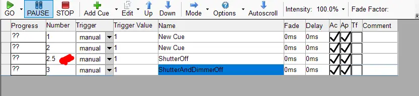

    I have one more question regarding why a light turns on during cuelist release.
    I have a single cuelist in the project, so no background list or anything.
    The cuelist even has a final cue with "shutter off".
    However, when the cuelist releases, the light turns on briefly, resets all settings, and then turns off again. I want this to happen with the shutter closed so there are no unsightly effects.
    I have even tried a second "end" cue that sets shutter off and then shutter and dimmer off. This causes the light to turn on between the last two cues and then fade back to 0.
    This cannot possibly be standard behavior; what am I doing wrong??

  • Hello,
    I have tracked the problem down to a fixture issue. The dimmer is 0-255, but if reducing to below 5 (especially quickly, like during a 0ms release), the dimmer turns on briefly regardless of shutter!
    I have fixed it in the DDF:
    Code
        <!-- Dimmer -->
        <!-- It is 0-255, but between 0-5 the light will flash on briedly even with the shutter closed -->
        <dimmer dmxchannel="4" defaultvalue="0">
          <range type="linear" mindmx="5" maxdmx="255" minval="0" maxval="100"/>
        </dimmer>
