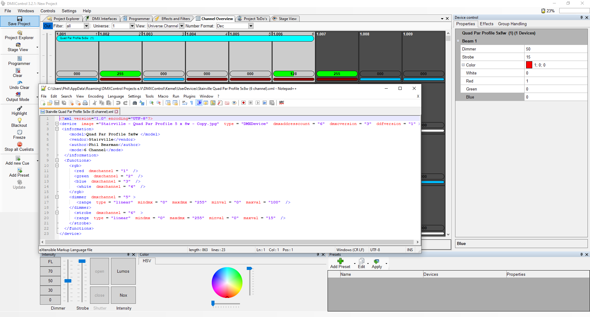

    For some reason my channel outputs are all being offset by 1 channel.
    See the screenshot below. I've got a single RGBW par in this project. It is starting on channel 1 and uses 6 channels.
    I've set the properties to red at 100%, dimmer at 50% and strobe at 100%.
    I would expect channels 1 (red) at 100% 5 (dimmer) at 50% and 6 (strobe) at 100% as shown in the DDF.
    But instead I'm getting channels 2, 6 and 7. Channel 7 isn't even assigned to a fixture!
    Any ideas why I'm getting this offset?
