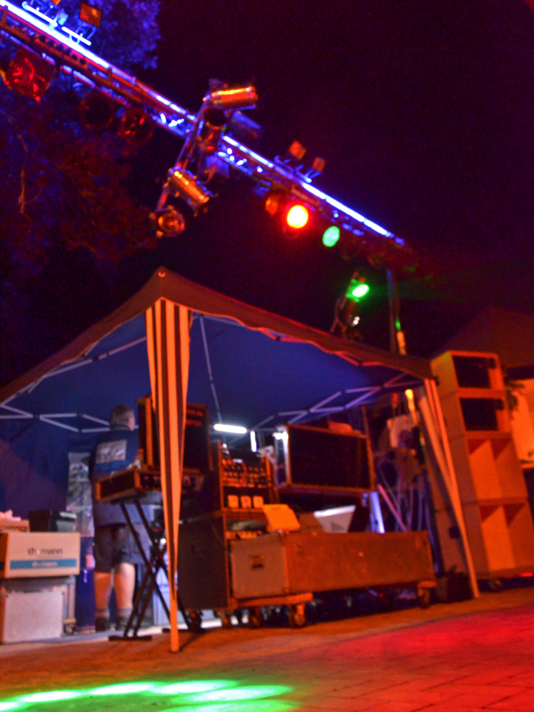

For several years we have been providing music and lighting in the beer garden of the Knodschen Haus in Aurich / East Frisia on the market square during the town festival. They were always exhausting days because of the set-up and dismantling. But it was always a lot of fun with the guests. We already had a small fan base there. Some from the region kept coming back to us. A few also came especially for the city festival to dance in our beer garden.
The wooden box with the monitor on it was our lighting control system for some time before the usage of DMXControl. It was a PC with plug-in cards for DMX out, analog in for the faders and a digital I/O interface for the button and LED displays. I had written the program myself using Turbo Pascal. The whole thing is on the 48-channel dimmer rack.

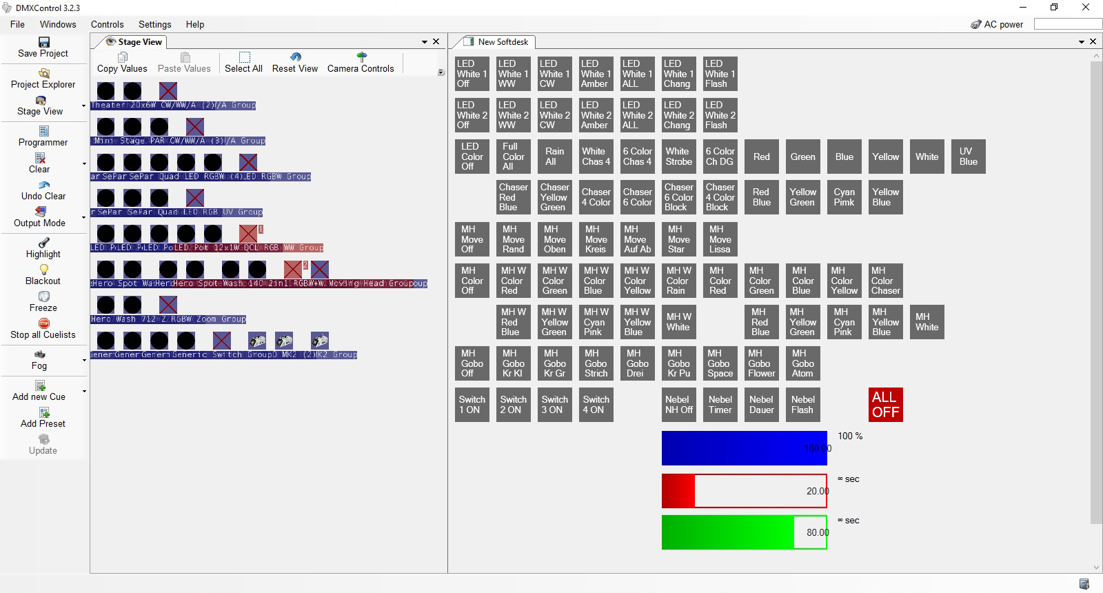

Once I had collected all the DDFs, I was able to start the project. I added the spotlights and moving heads to the stage view and adjusted everything. I also created effects for the devices for testing purposes.

I have also created two layouts. One for programming and one called Show on which, for a better overview, only two elements are visible. The stage view on the left and the softdesk on the right.
On the second programming evening, I then took care of a few more effects. I built a few more chaser effects for the RGB devices. I also created a few color lists for the color chasers. I also created some color and gobo effects etc. for the moving heads. It already looked good and worked well.

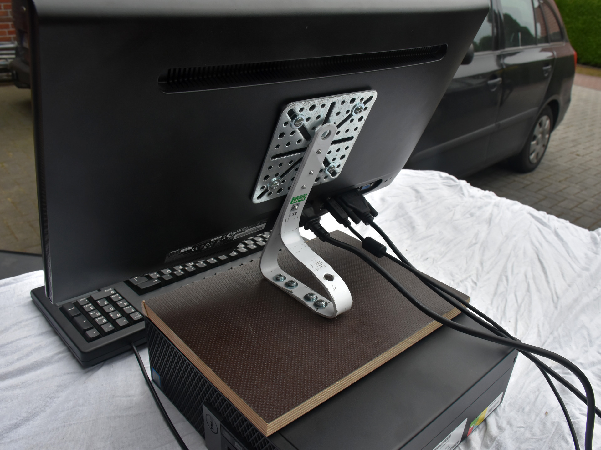

The PC is an older Dell Optiplex 5040 with Windows 10. I bought a Cherry keyboard with touchpad for the keyboard and mouse. I use a 19.5" ASUS touch monitor. I built a stand for the monitor. This consists of a piece of wooden plate with rubber feet. The monitor holder is screwed onto this, bent from an old speaker bracket and a perforated plate connected with rivets. The base plate of the home-made stand happened to fit the PC exactly. The whole thing can therefore be set up very compactly. In retrospect, the whole thing looks a bit like a cash register PC.
Now transfer the project to the PC and set up the interface. Because the monitor has the same resolution (1600x900) as my laptop, I didn't need to make any further adjustments to the display. A little more testing and the preparations are complete. As the monitor has a 10-point multi-touch function, several buttons on the softdesk could be pressed simultaneously. A great function.

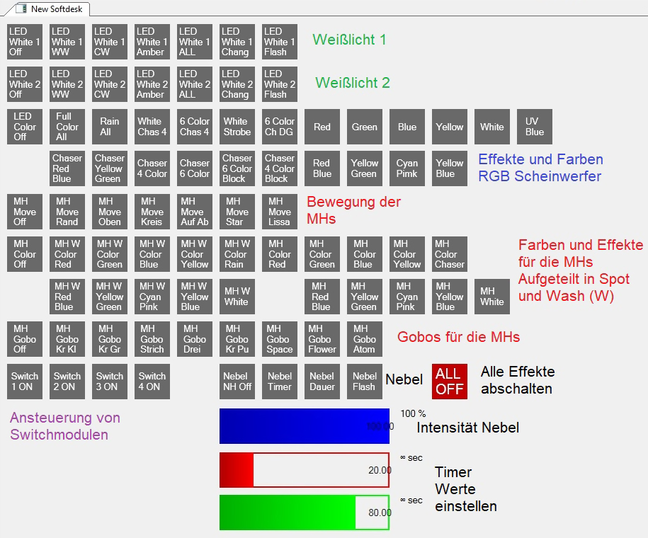

Briefly about the project
I created different effects for each spotlight group (white and RGB+) so that I could combine them flexibly. For the moving heads, I divided them into movements, colors, and gobos. Separate effects have been created for each area so that they can also be flexibly combined here. The buttons for the switch modules can be switched independently of each other.

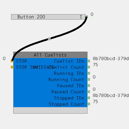

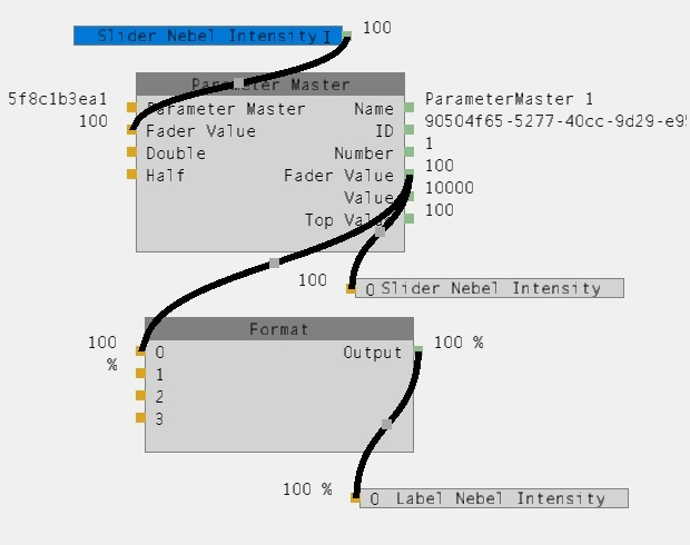

There are four buttons and three sliders for fog. The buttons can be used to switch off the fog effects and activate the timer function, whereby the machines then run alternately in a time-controlled manner. The "Fog duration" buttons activate an effect for both machines, where they fog with a set intensity. When the "Flash fog" button is pressed and held, both machines run at 100%. The blue slider determines the intensity of the timer and continuous fog effects. The red slider is used to set the duration of the fog output and the green slider is used to set the interval time, i.e. the pause between two secondary bursts.
