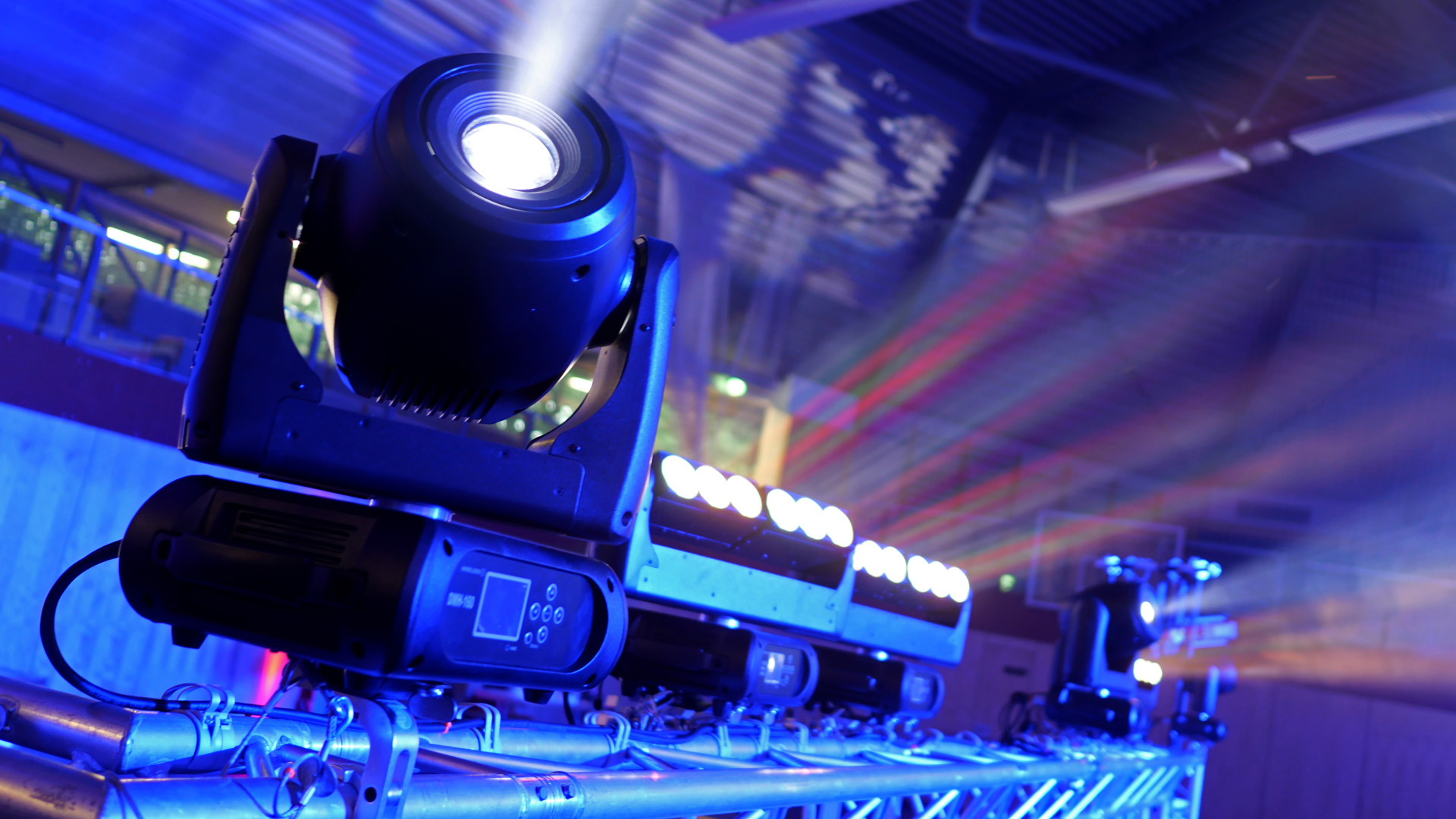

Instead of simple stepped lens fixtures, we used a total of 16 Clay Paky Mini-B in the warm white variant here, which we distributed around the ring on four towers with a height of 4.5m. Using seven RGBWW LED chips with a rated power of 40W per chip, we not only created a super uniform light in conjunction with the zoom optics. The light was also very pleasant in terms of color temperature. This gave us excellent illumination for the fights. If nothing was happening in the ring, the Mini-Bs were available to us to brighten up the hall during the breaks or to illuminate the red carpet where the athletes and their teams entered the hall accompanied by music.
To ensure that all the light was not concentrated on the ring alone, we positioned a truss arch behind each of the seating blocks on the stadium floor. On this we mounted three Futurelight DMH-160 and four Futurelight Mega Color Wave.i. Due to the elevated position on the truss arch, the light of the devices was not obscured by the audience, even if they were standing. The latter was not a rarity that evening. Together with two Futurelight DMB-160s each, which we positioned on cases on the long side of the hall opposite the main grandstand, we filled the entire hall with light, especially since the use of haze and other fog effects was explicitly requested for the event.

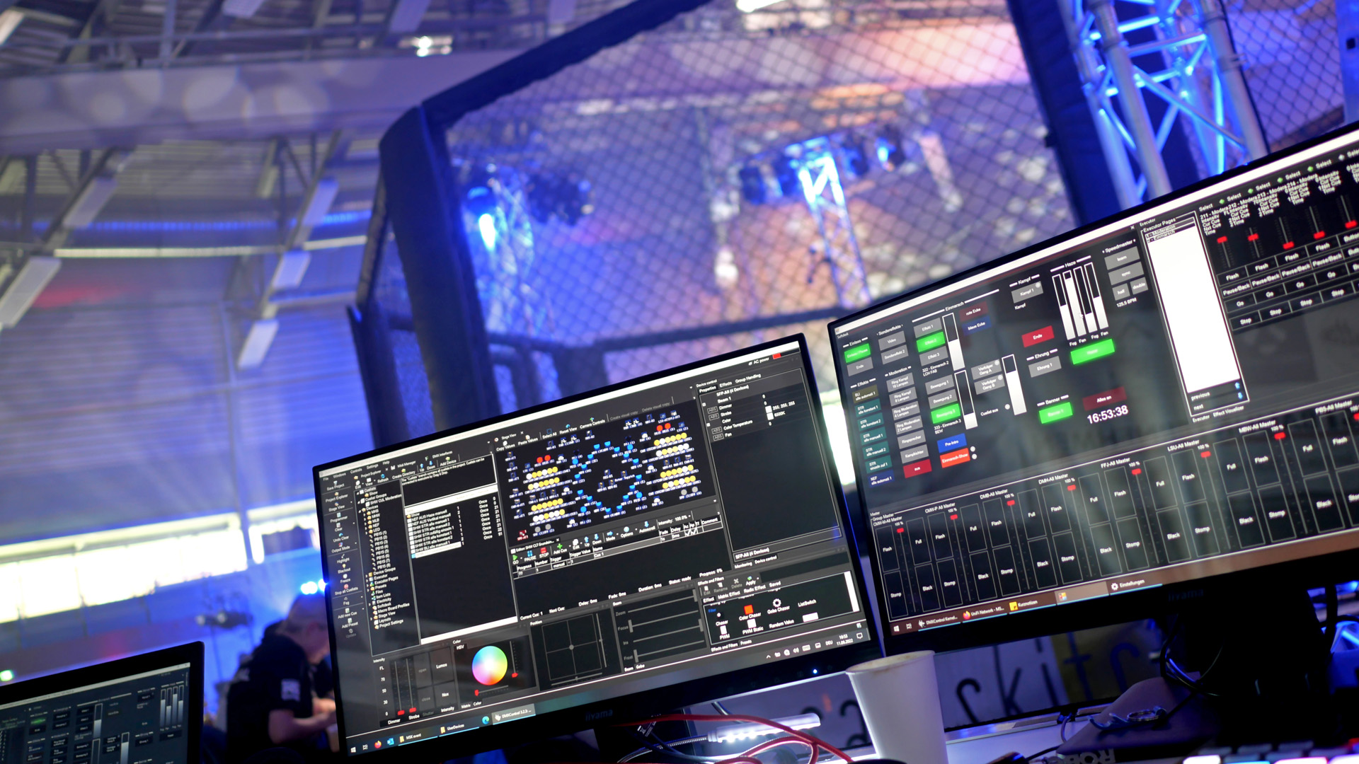

If you've been following my previous Live@Work reports, you're probably familiar with the phrase: I've re-adapted my existing project to the new location. For this event this statement does not apply. Since a long time, I have designed and programmed a project from scratch in DMXControl 3.2.3 once again. The main reason here was that the sequences such as marching in, change between fight and break scenes, award ceremonies etc. could not have been integrated into my classic club show projects without further ado. The use cases were simply too different here. In the end, I only wanted to press one button at a time to immerse the hall in the corresponding scene. Because the declared goal in my place was: I wanted to create an atmosphere and dynamics in the lighting staging that you often only see at large events in the martial arts sector. Here, it clearly played into the fact that I have not only seen numerous fights in boxing on TV. It also resulted in being already live on site as a spectator.
Accordingly, I included elements like red and blue corners as well as dynamic transitions between fight rounds and ring breaks in my programming. So, I had prepared a small construction kit with dimmer effects and movements for the entrances, which I could then assign to the respective corner in terms of color. With this I could bring a bit of variance into the marches, which I further individualized with manually pressed strobe effects. During the fight, only one cuelist ran as a loop, which I switched depending on the situation. The corresponding change of the ring illumination was also built in. For the fight, all 16 Mini-Bs always directed themselves into the ring. During the ring breaks, I pulled off eight devices to highlight the respective corners in color. For the announcement of the winner, I had also prepared my own cuelist.
In order to be able to run all the prepared cuelists in a targeted manner, a lot of attention was paid to the priorities of the cuelists during the programming in advance. Here I had to think about a proper concept, which cuelist may be overlaid by another one and how. Highest priority got here the ring lighting, which I was not allowed to switch off straight during the fights.
