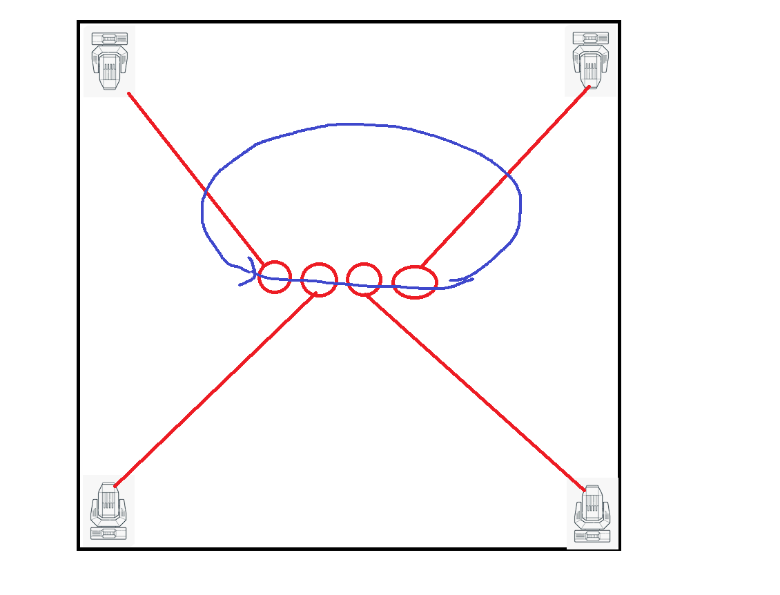

    Hello DMXControl users,
    I have recently started playing with this software and find it amazing; I am very happy with it. I am new to lighting and have tried some other softwares also.
    I did come across an issue though that may be a showstopper for me, and I imagine I am doing something wrong because the software is so well thought out.
    Here is my scenario:
    I have 4 moving heads, one in each corner of a room.
    I would like to calibrate them to the floor, and create effects where they can move in sync. Essentially I want to map them to a coordinate system of the room.
    They should be able to point to the same spot, and from there pan/tilt in sync across the floor. This would also facilitate fanning and effects.
    Another software I tried was PC_DIMMER, and it had such a calibration feature in the device settings
    How can I accomplish this in DMXControl 3?
    Here two examples; all pointing and following the same spot on the floor with pan/tilt movement, and the second one where they are fanned and following a circular pattern, for example
