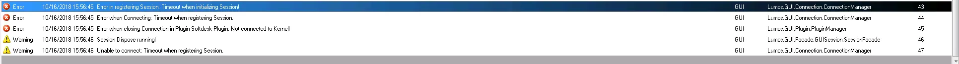

    Gui 2 logs say timeout when registering session. I don't seem to have any network connectivity issues otherwise. One is wired, one is wireless, same subnet, there are smb shares between them, pings respond, everything appears normal, the gui server lists pick up the kernels but neither one will connect to the other kernel with the same results and log either direction.
