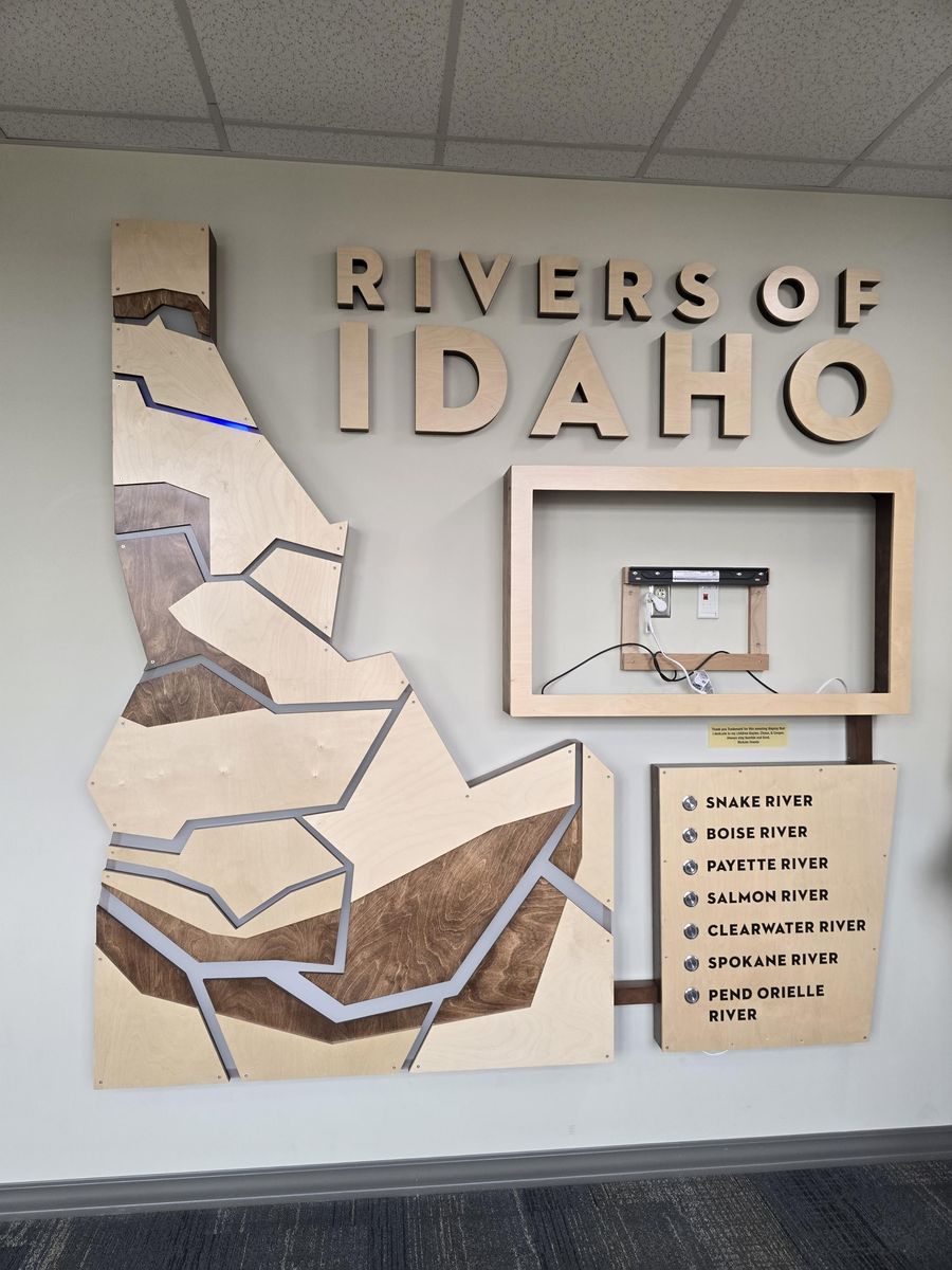

Under the translucent material you see in the display are 9 LED strips. There are only 7 rivers, but due to physical layout, 2 rivers require 2 LED strips. The basic operation here is the child presses a button and the associated “River” lights up. There is also a video that plays with each river.

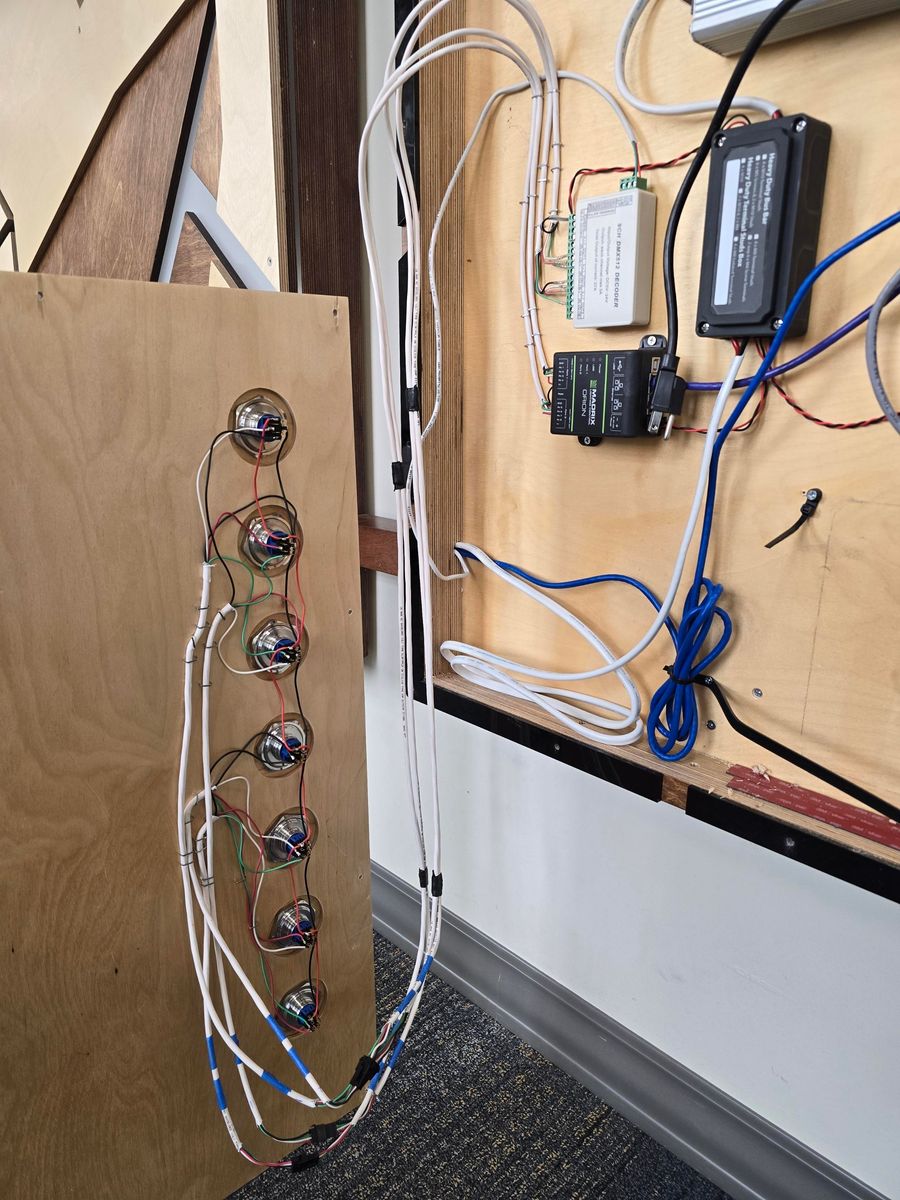

These LED strips are connected to a “Ethernet-SPI/DMX Pixel light controller”. Using QLC+ I have determined and tested that that these strips can be reached at a private local IP address. The ArtNet devices are connected to a PC that has its ethernet adapter configure to a local network all with fixed IP addresses and no router/gateway/DNS. The Wi-Fi adapter of the PC is connected to our internal secure network and that is how I communicate with the PC. This PC is the one which I run QLC+ and hopefully a program written by me utilizing the ArtNetSharp library. I develop the program on my work PC and copy the executable to the display PC.
The nine LED strips are connected to the SPI outputs on the controller are reachable at the IP address of 10.0.33.20, Universes 1-9 respectively. Using QLC+ I can make them turn on blue.
Also connected to the “Ethernet-SPI/DMX Pixel light controller”. Is a 9 channel DMX512 Decoder via DMX512 output port 1 with a three-wire connection. Based on the configuration of the Ethernet-SPI/DMX Pixel light controller the DMX512 Decoder should be reachable on Universe 10 but I have been unsuccessful in connecting to it. (Suggestions? I think it may be failed hardware at the test functions controlled by dipswitches do not work.) The DMX512 Decoder drives LEDs in the buttons on the display.

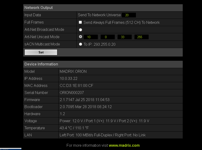

The Buttons are connected to an Madrix Orion ArtNet input device. Using QLC+ I can detect button presses at the fixed IP address of the input device on/in Universe 20. The short comings of this device are such that it cannot be configured (as confirmed by many messages with support) to send exactly one message that has the value relating to a button press. This results in a random number of messages that a button has been pressed. Each message toggle the button function in QLC+ turning the function on and off each time. This inability to de bounce the button press with either the Madrix Orion or QLC+ is why I have to try to write my own program. (external de-bouncing will not work)
