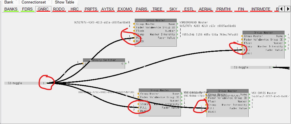

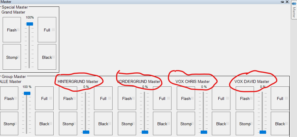

    I have 4 light Groups, for which I have assigned 4 input faders that control the level of their corresponding group masters. I have connected the faders to 4 midi channel Continuous Controllers to help me program the intensity of the groups while a Reaper project plays.
    My purpose here is to have some pauses in my show between the songs, where a cue is triggered by a noteon event and then the project PAUSES. when the pause completes, the cue that I have designed to play during the pause, is stopped on another noteon event ( i use the toggle option for that case to be achieved ). This seems to work right! The problem comes when the midi controlled masters return to zero when the playback pauses! And that's even if they seem to be working on FULL on the input assignment graph viewer. Since it's a bit complicated to explain very well what I am experiencing, the following screenshot might help a bit more!
    The "buggy" behaviour is depicted on the screenshots:
    The toggle control has set "1" on the FULL input of all 4 group masters but at the same time...
    The actual group master faders are all on set on zero!!!
    The playback is paused, but the cue has been successfully triggered!
