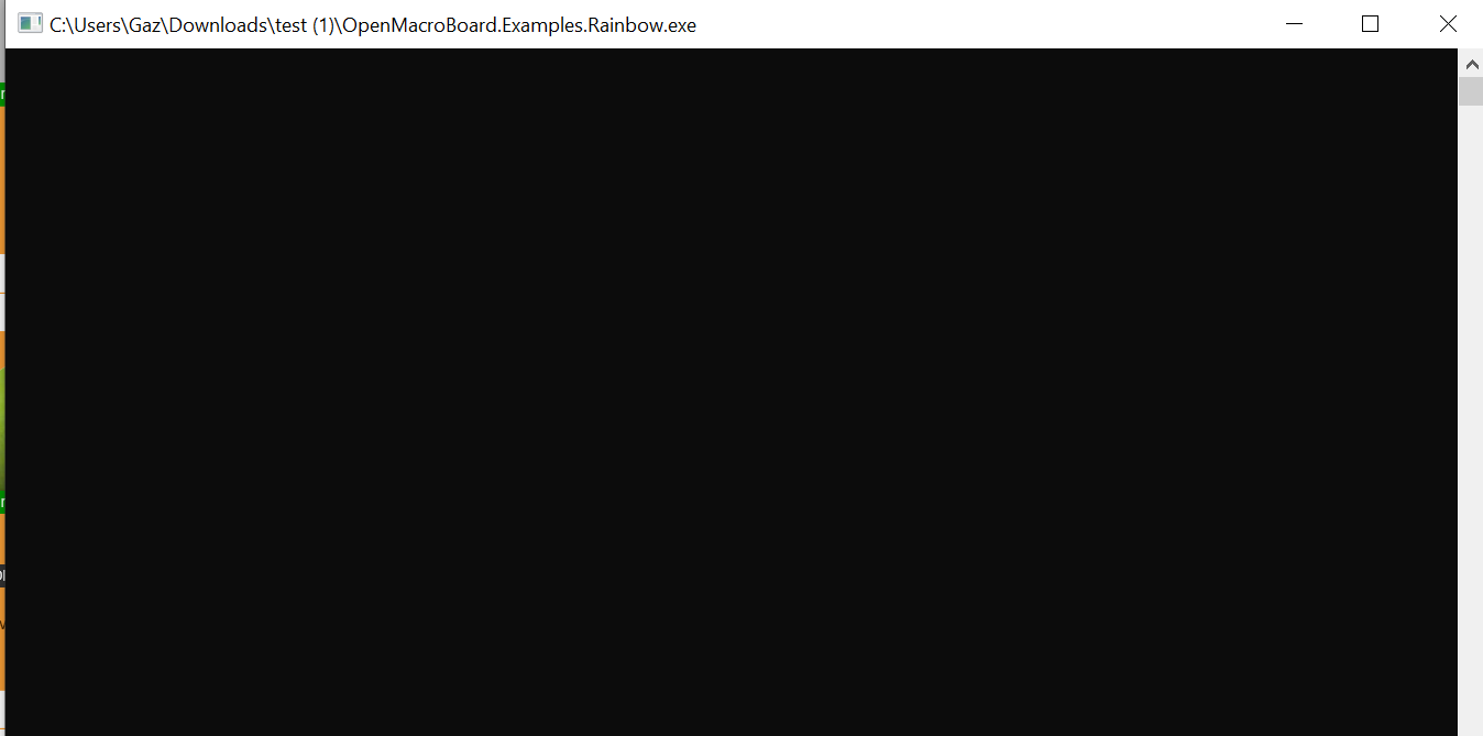

It just opens with a blank screen.
I restarted the pc to make sure.

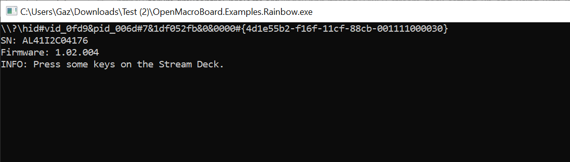

I put the hid.sharp.dll file in the test folder, and it is now doing the following:

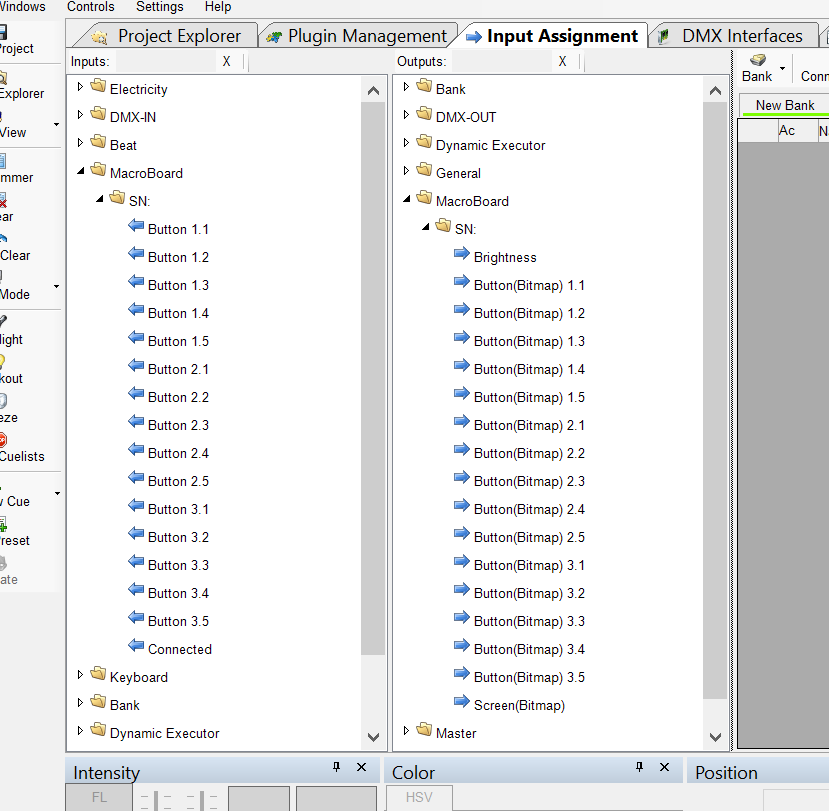

We now have a MacroBoard on the input assignment!!! There is no serial number listed, and no animation on the stream deck, but the buttons are listed if you open the SN.
Didn't work. I also replaced the file in the test folder, but nothing happened either.
When I run the test program, the output windows stays open for a little bit. It says something about an unhandled exception: System.io.FileNotFoundException:

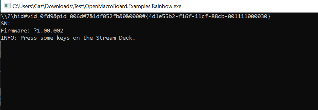

I have unzipped the folder, and run OpenMacroBoard.Examples.Rainbow.exe - Nothing happens. Should I be running this stand alone, or while DMX Control is running?
When I restart the laptop with stream deck connected, the steam deck app launches with the welcome button shown on the stream deck. I closed the stream deck app before launching OpenMacroBoard.Examples.Rainbow.exe

Can you confirm that something should be showing up on the area that I have highlighted on my previous picture?
I have got the laptop to connect to the kernel on my desktop. The stream deck is connected to my desktop.
Assuming that I am looking in the correct place, nothing is listed under the input assignment on my laptop for the stream deck.
