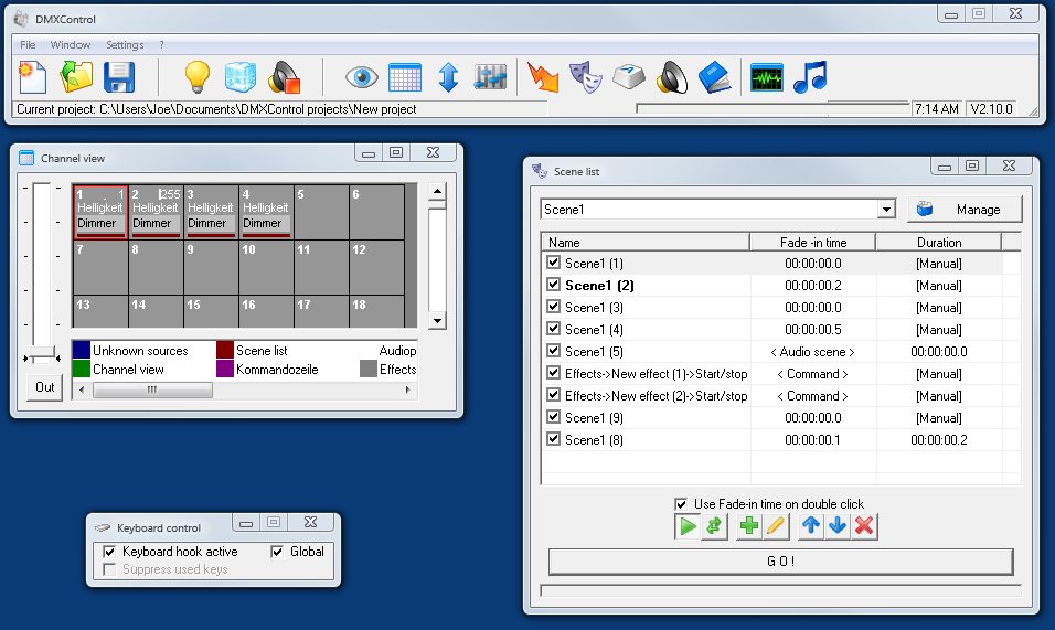

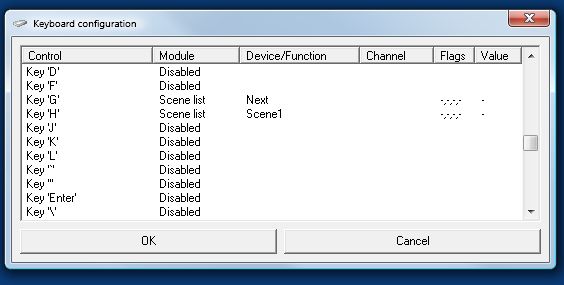

    Philip may have found one issue. I was unaware that that window had to be open. I do not know what all the options in the "keyboarcontrol" window are. I just noticed that there are TWO windows by the same name. The window where you set the key-command options, and another where you enable the keyboard control. It might be best to have them combined into one window. Just have a button on it that expands or collapses the actual key-command settings. And if the keyboardcontrol window must be open for it to work, then a note on the windows should say that.
    However, I still cannot get it to work. I have attached some screen grabs of my settings. That may show you what is going wrong.

    I also have the Logitech Cordless Presenter 2,4 GHz. I now realize that it will not work for DMXControl, unless I remap the keys. However, I cannot figure out how to get DMXControl to advance to the next scene by using the keyboard. I am guessing, but your script for Autohotkeys seems to use the + and , keys to change scenes. But, without using AutoHotKeys, the + and , do nothing.
    So, I imagine that you had use the keyboard control that is inside DMXControl to make + and , do something. All the keys are set to "disabled" by default. I tried to change some of them, but do not understand how the various options work. I tried the following settings to try to get the spacebar to cause the DMXControl to go to the next scene and backspace to go back a scene.
    .Control........|.Module.....|.Device/function
    .Key 'space'....|.Scene list.|.Next
    .Key 'Backspace'|.Scene list.|.Previous
    I tried it with the scene list closed, with the scene list open, and with the scene list open and the "play" button down. But, the only time there was an effect is if the "play" button is down, and I press the space bar... but that worked only because windows has the space bar serve the same as a mouse click when a button has focus. The backspace had no effect. So, I don't think my keyboard configuration efforts had any effect. What am I doing wrong?
    Joe Dunfee
    p.s. I tried to use spacing on the message editor with a Courier font to make them line up, but the spaces are not coming up as mono-space. So, I switched to ... to get them to line up. I guess the best thing would be to include a screen grab, but I can't figure out how to put the picture inline.

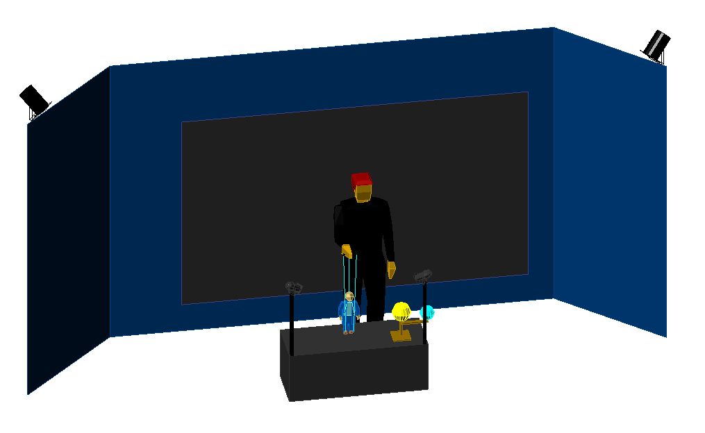

    I want to use DMXControl to run both lights and PowerPoint. I will be performing on stage with marionettes, and will have a rear-screen projection system behind me. Each segment of the performance will require different lighting settings, have music, and play a short PowerPoint presentation that may have an animation or video embedded in it. Attached to this message is a drawing of the set-up.
    In my pocket I will have a remote control. By pressing a button on the remote control I will trigger the "go" button to change to the next scene.
